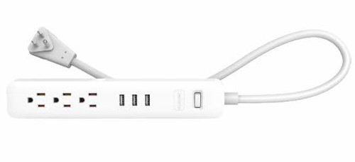

About Wyze Surge Protector
Wyze Surge Protector gives you 3-USB ports with smart IC technology provide fast, efficient and simultaneously charging of small devices and 3 Type B grounded outlets.
Wyze Surge Protector has a 268 Joules suppression rating for power surges, 20µA ground fault protection, and overload protection that automatically switches the power off when the current reaches its limit of 15A. Wyze Surge Protector is also scratch-resistant and flame retardant up to 1,380℉ (750℃). Wyze Surge Protector is also Ul listed and FCC certified.
Wyze Surge Protector Specifications: AC 15a, 125V, 60Hz, 1875W, 4-foot long 14 awg power cord, UL listed and FCC certified.
