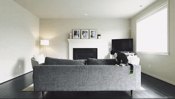

Motion Tagging shows a green box around objects in motion. This helps when scrolling through a lot of footage to see if and where motion happened.
Here's a clip of what Motion Tagging looks like:
