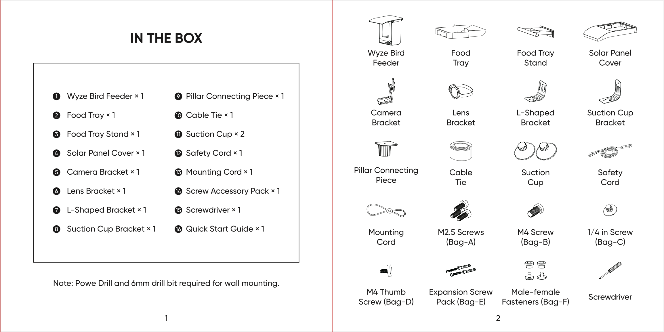

  • What's in the box for Wyze Bird Feeder.

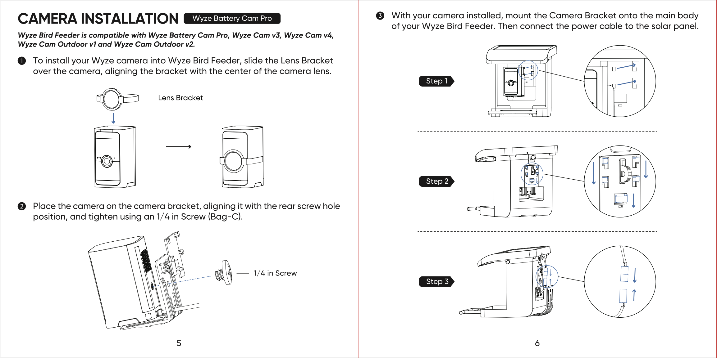

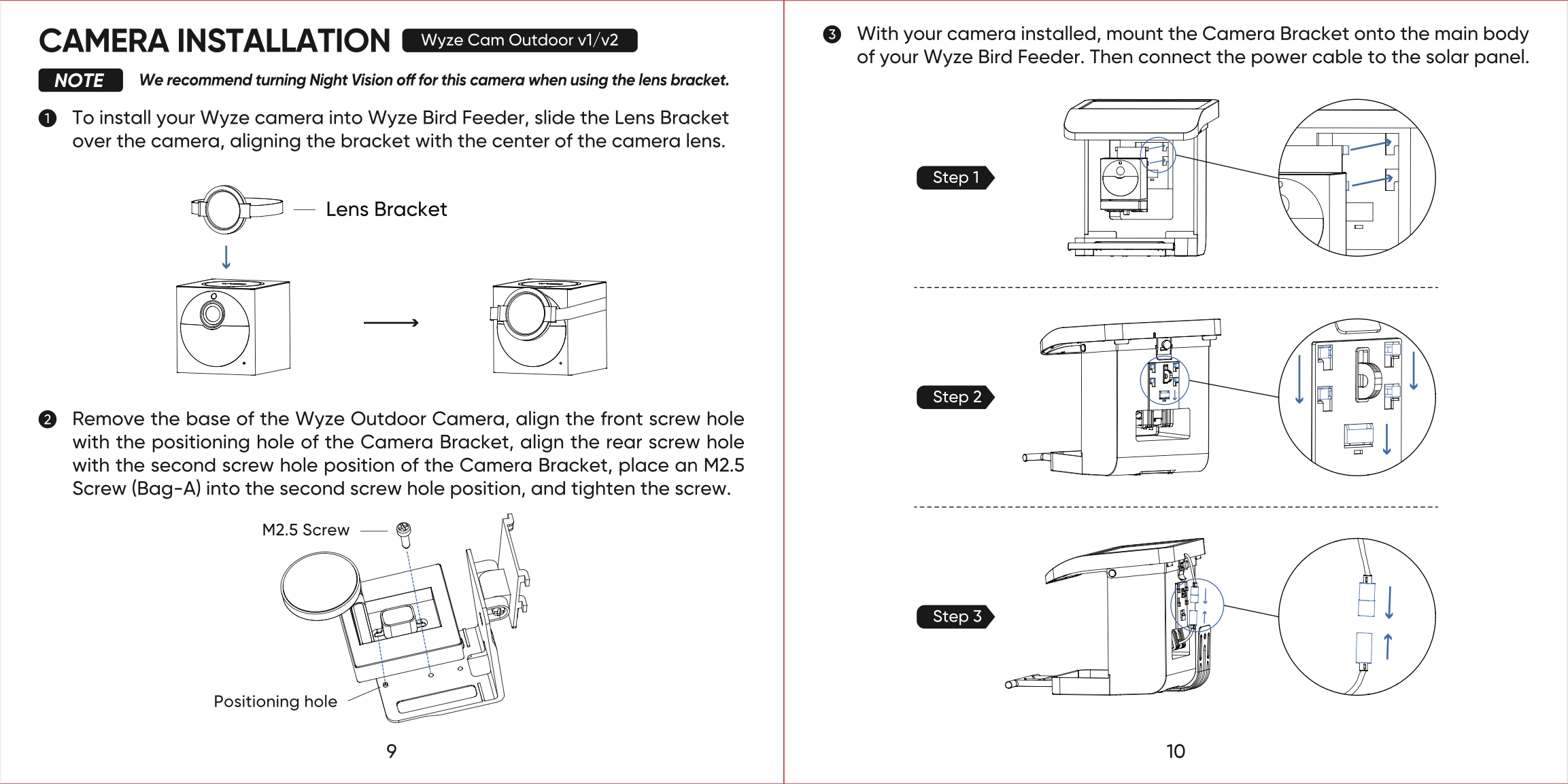

  • How to install your Wyze Cam in the bird feeder.

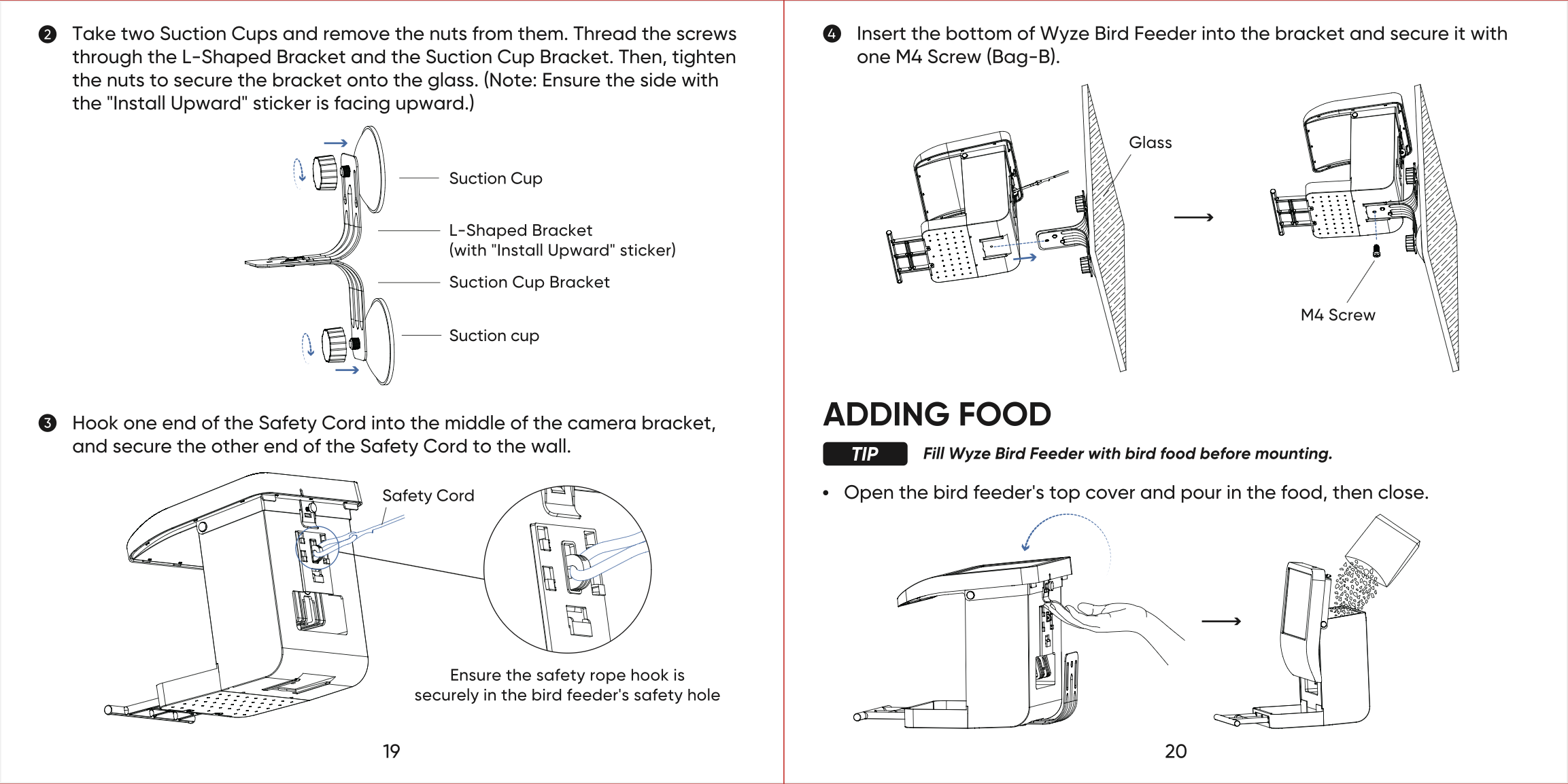

  • How to mount your Wyze Bird Feeder.
