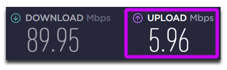

  • Slow internet speeds can also cause these errors.
    • Test your internet speed by going to https://www.speedtest.net/ on the smartphone or tablet you are using and run the test.
    • Wyze Cam needs a minimum upload speed of 1-2 Mbps for SD and 4-7 Mbps for HD. Try connecting to a different network or lower the traffic from other devices on your network if you are below the minimum.
 Upload Download Speedtest
Check for the upload speed, not the download speed, of your network.
