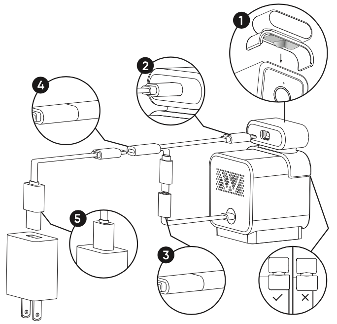

  2. Refer to the image below for a quick view of what goes where.

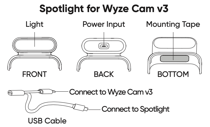

    1. On the spotlight's USB cable, find the Connect to Spotlight tag.
      • Connect this end of the cable to the Spotlight.
    2. Unplug your Wyze Cam v3 from its power outlet.
    3. Disconnect your Wyze Cam v3 from its power cable
    4. On the spotlight's USB cable, find the Connect to Camera tag.
      • Connect this end of the cable to the camera's cable.
    5. Connect the spotlight's USB cable to the v3's power cable.
    6. Plug the v3's power cable back into the power outlet.

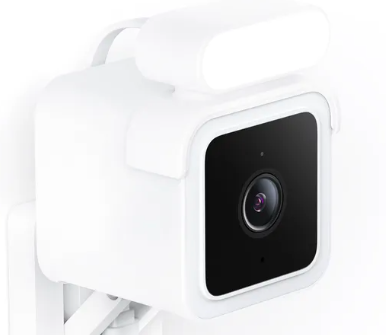

  5. Finally, install your spotlight onto your camera
    1. Remove the adhesive strip underneath the spotlight.
    2. Attach the spotlight firmly to the top of the camera, making sure it's flush along the front of the camera.
  6. Once the spotlight is attached, you're all set!
Wyze Cam v3 + the Spotlight Kit connections in detail:
