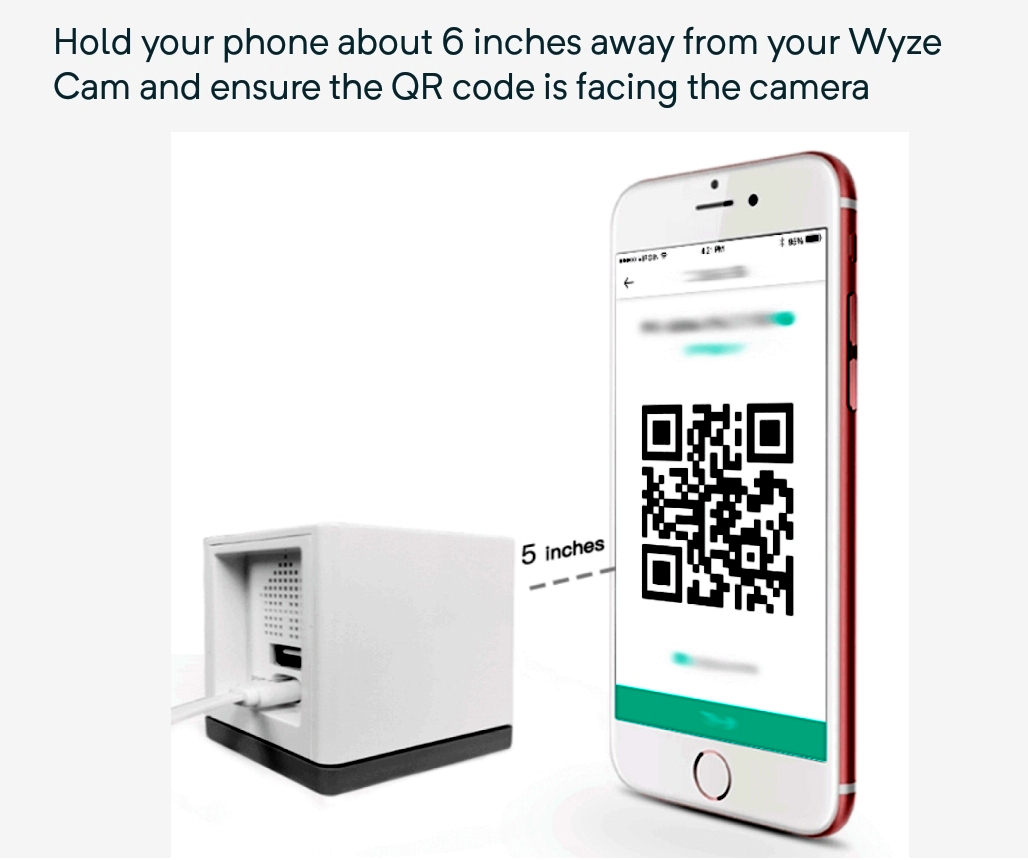

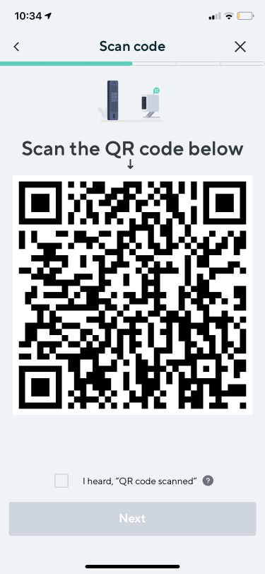

  9. Scan the QR code on the Wyze app.
    • Hold your camera up to your phone screen with the QR code displaying. It will say “QR code scanned, please wait” then “setup completed”.
  10. In the app, check the box next to I heard, “QR code scanned”.
  11. Tap Next. You’re set up, it’s time to name your device.

  • Having trouble scanning your QR code? A few tips to help:
    • Hold your camera 6-10 inches away from your phone screen.
    • Slowly move the QR code on the screen away from the camera, then closer.
    • Tilt your phone screen slightly in case there's a glare.
    • Turn your phone upside down.
    • If you're on iOS, turn off "Invert Colors".
    • Make sure the QR code isn't distorted.
      • If you have an older device, the screen may be too small. Try a different device.
      • If your screen is cracked or scratched, the code may be distorted. Try a different device.
      • If you're using a beta version of the Wyze app, make sure the cursor is not on the QR code.
