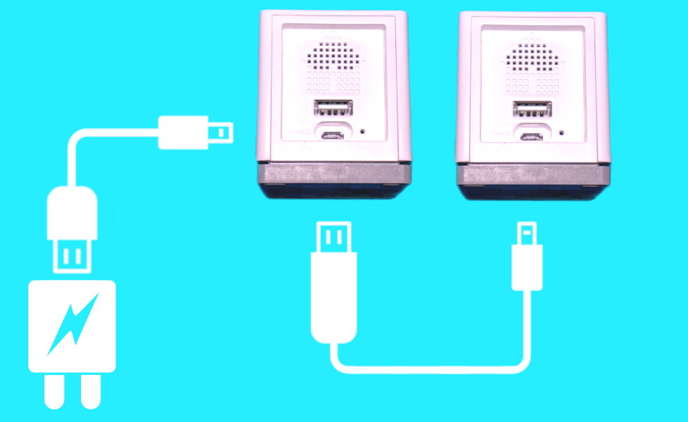

How Daisy Chaining Works
A Wyze Cam v2 or Pan that is plugged into an outlet can use a standard USB-A to microUSB cable to pass power down to another Wyze Cam v2 or Pan. You can power one additional camera by daisy chaining them. Giving you a total of two cameras powered from a single outlet. Try the following steps when daisy chaining:
Note: Wyze Cam v3 and newer Wyze Cams cannot be daisy chained for power.
  1. Plug in the first Wyze Cam v2 or Pan using the included microUSB and power adapter. Connect the microUSB (smaller end) to the first camera.
  2. Check to see if the camera works by navigating to the camera's Live Steam in the Wyze app.
  3. Plug the USB-A (larger end) into the first camera and the microUSB (smaller end) into the second Wyze Cam.
  4. Check to see if the second camera works by navigating to the camera's Live Steam in the Wyze app.
Daisy Chaining Wyze Cam v2
