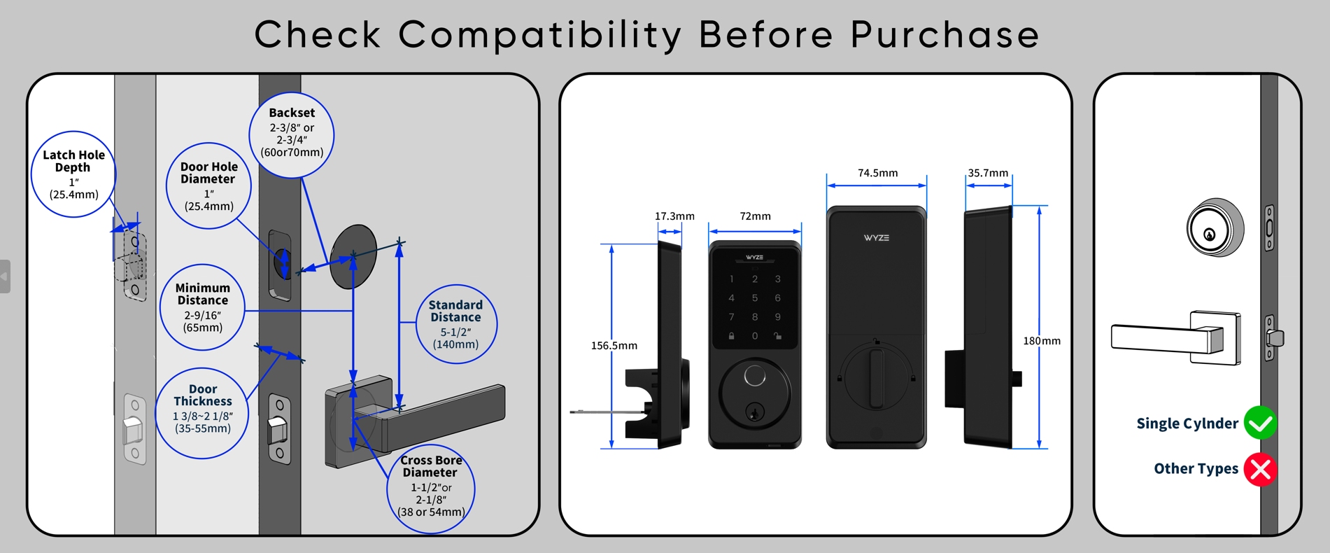

Wyze Lock Bolt v2 is compatible with standard thickness wooden exterior doors with a single-cylinder deadbolt.
More door compatibility requirements:
  • Door type: Standard single-cylinder deadbolt on wooden exterior doors. Not for glass or sliding doors. Does not support Mortise or multipoint locks.
  • Door thickness: Requires a door thickness of 1-3/8" to 2-11/64" (35–55 mm).
  • Cross-bore (main hole) diameter required: 2-1/8" (54 mm) or 1-1/2" (38 mm).
  • Edge/latch hole (face-bore) diameter required: 1" (25 mm); latch-hole depth must be 1".
  • Backset required: 2-3/8" (60 mm) or 2-3/4" (70 mm) (deadbolt is adjustable).
  • Clearance from other hardware: Requires at least 2-9/16" (65mm) between the deadbolt center and the adjacent handle/doorknob.
  • Latch plate shape: Rectangular faceplate.
Here's a handy guide to check compatibility before purchasing.
