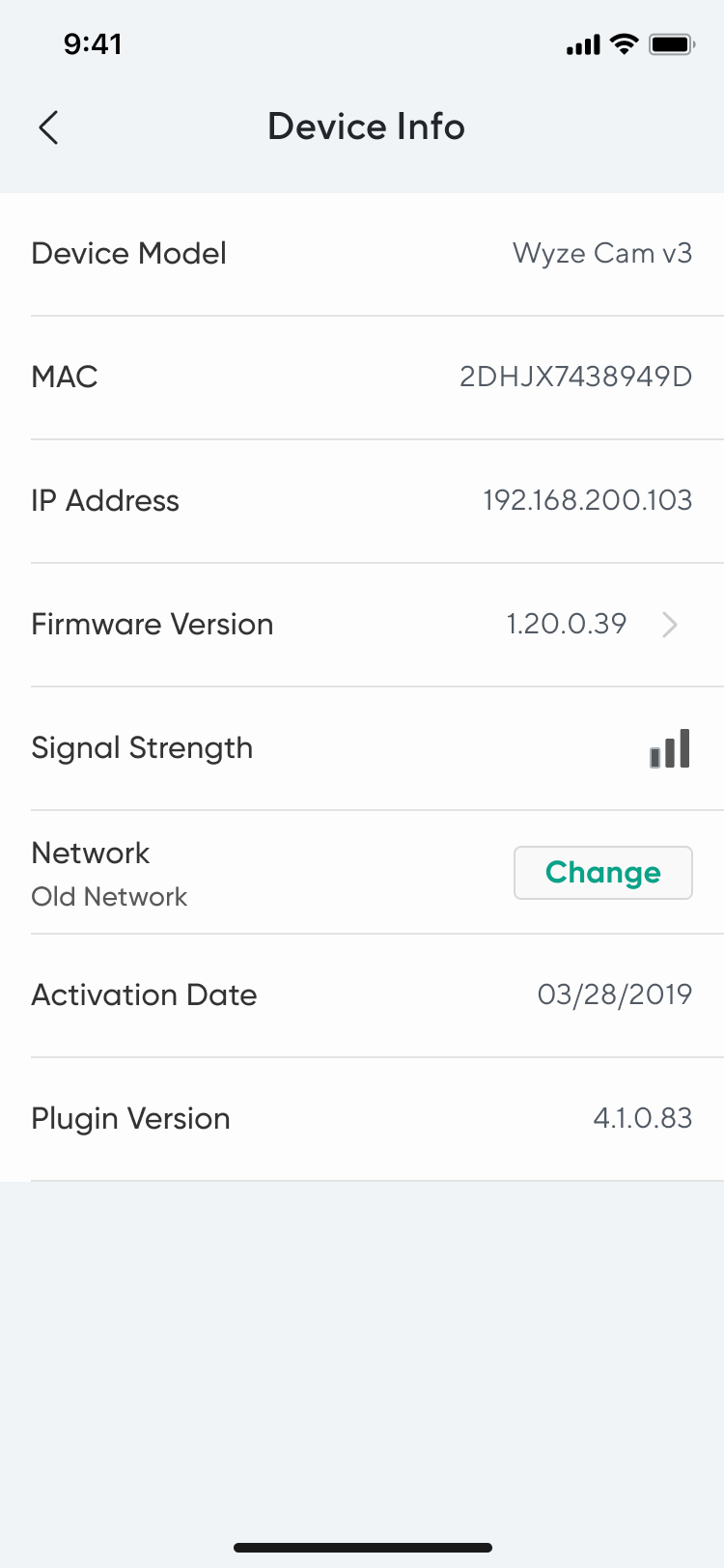

On most Wyze Cams, the only way to update your Wi-Fi details is by pressing the SETUP button and setting up the device as new in the Wyze app.
But on select Wyze Cams, you can go to your Device Settings > Device Info and tap Change to update your network details, as long as you're still online.
👉 If you have already disconnected your Wi-Fi, or are already offline, the Change button will not work.

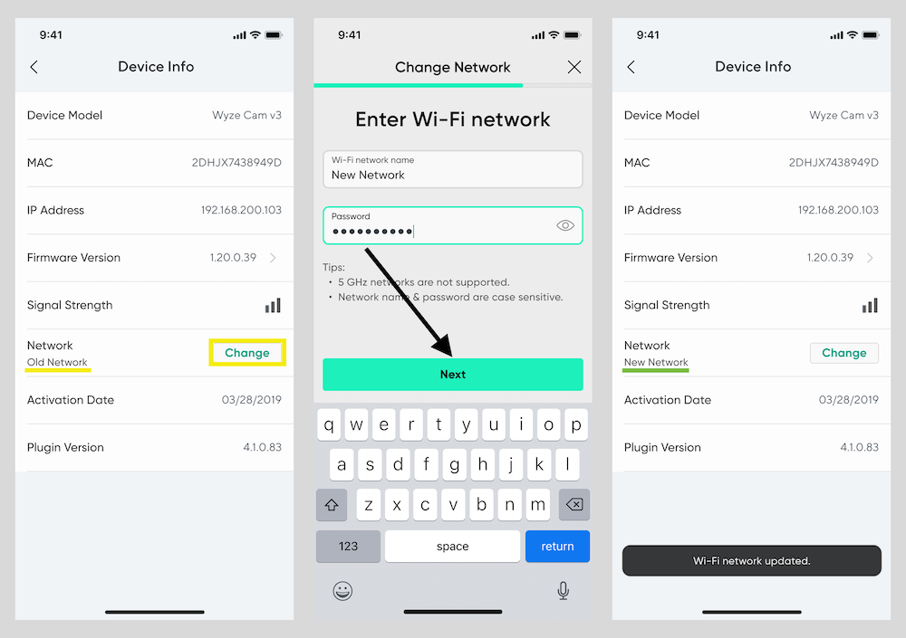

To use the Change button to update your Wi-Fi details:
  1. Important: If you have a microSD card installed, eject it before proceeding.
  2. In the Wyze app, tap on your Wyze Cam v3/v3 Pro or Wyze Cam Pan v3/v4.
  3. Tap on the settings gear on the top right.
  4. Tap Device Info.
  5. Next to Network, tap Change*.
    1. Enter your new Wi-Fi network name and password.
    2. Tap Connect.
