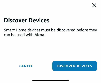

To pair your Wyze Garage Door Controller to Alexa:
  1. Open the Amazon Alexa app and tap Discover Devices.*
  2. When your garage door controller is found and connected, tap Set Up Device.

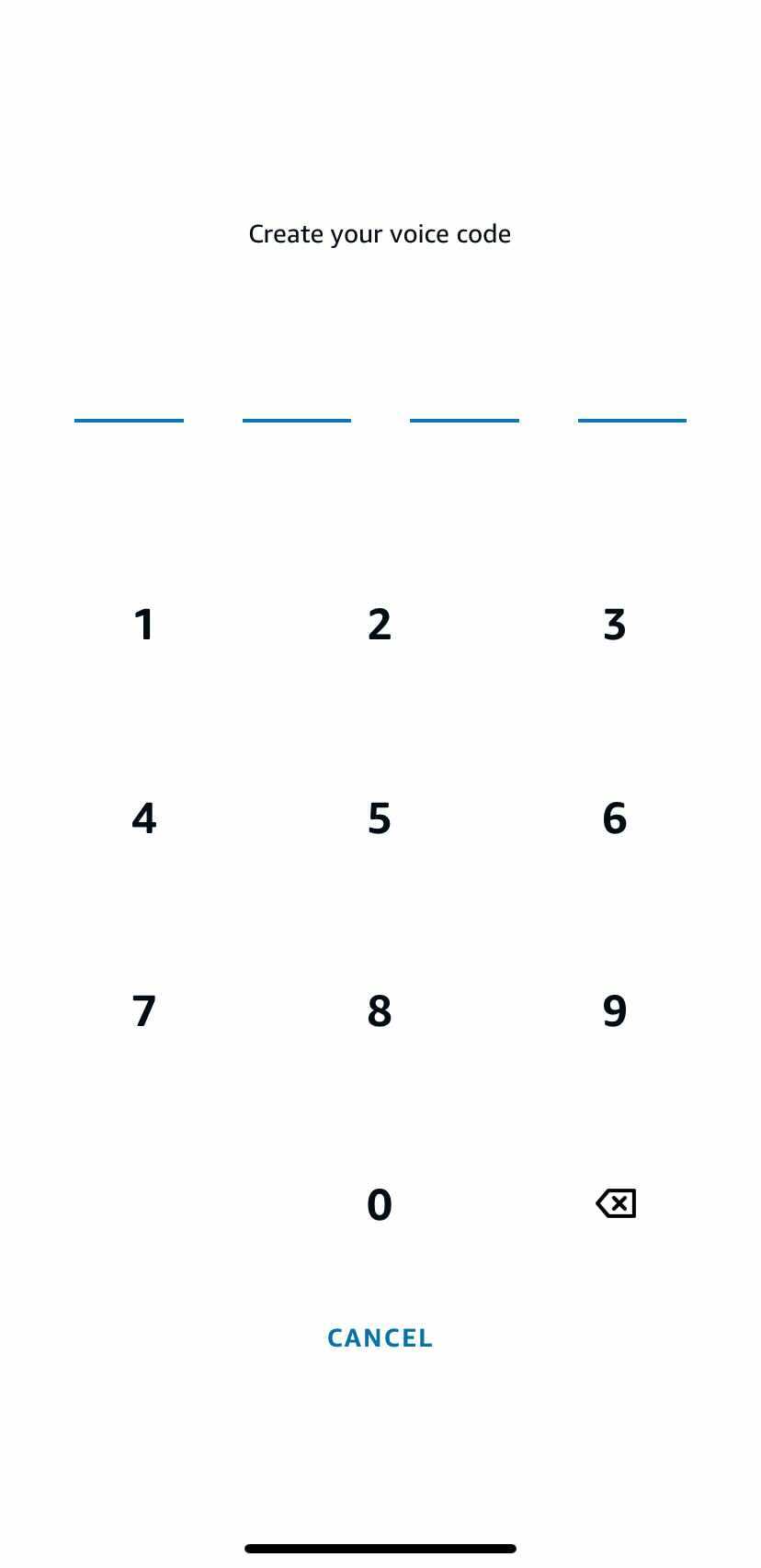

  3. Create a 4-digit voice code.
    • You'll use this code to open your garage.
  4. You're all set! This skill is set up and ready to use.

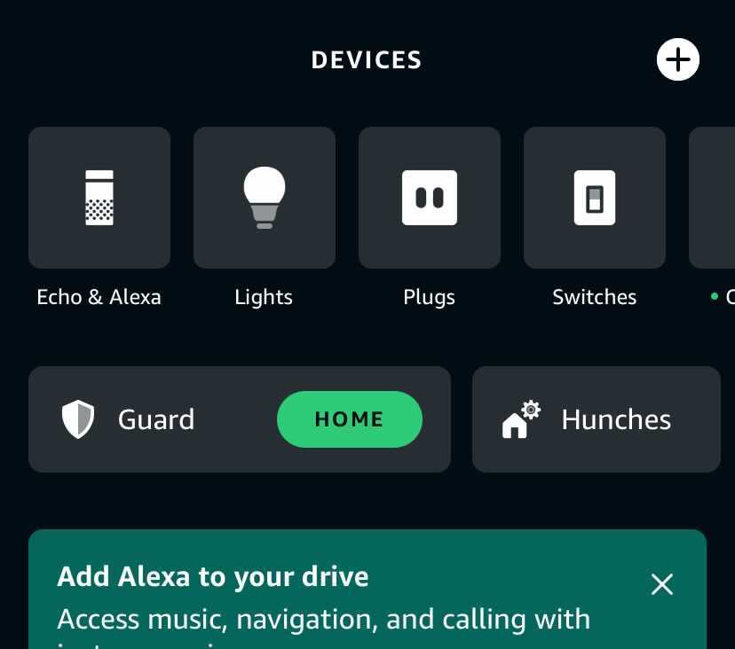

To check if Alexa has already discovered your device:
  1. Go to the Amazon Alexa app and tap Devices.
  2. If your Wyze Garage Door Controller is in the list, tap on it and delete it.
  3. On the Devices screen, tap the plus sign +, then Add Device.
  4. Select Garage Door. On the brand list, select Other.
  5. Select Discover Devices, and follow the steps above ("To pair..." to connect and create a voice code.
  6. You're all set!
