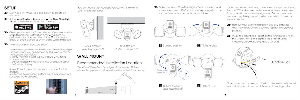

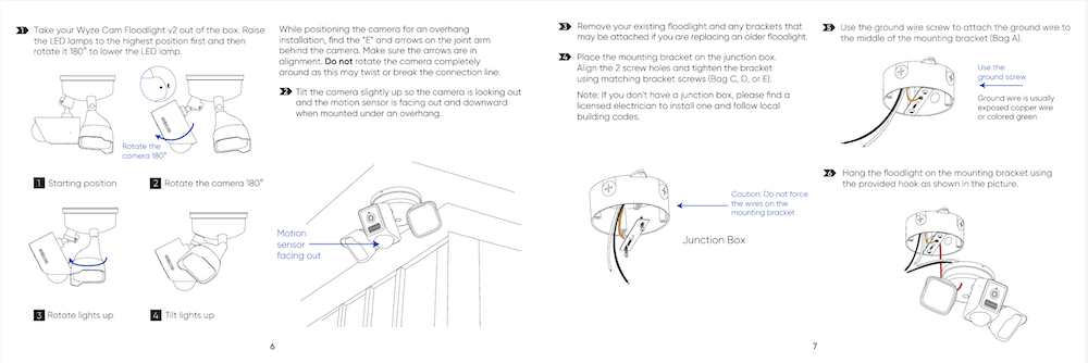

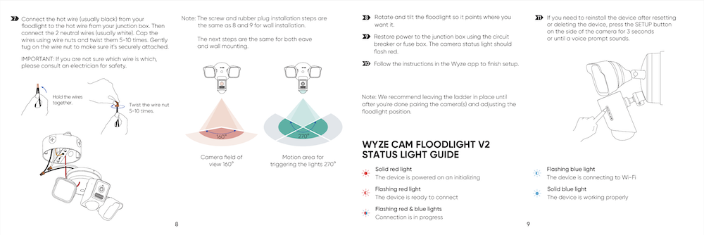

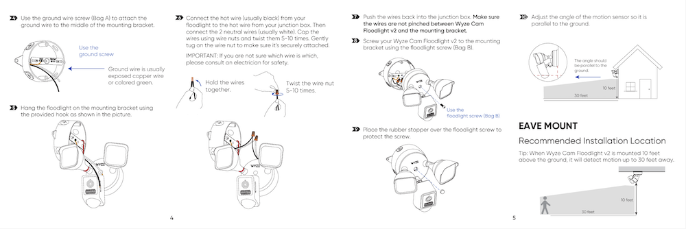

This guide is a short user manual with the basics about Wyze Cam Floodlight v2, including:
  • How to set up the floodlight.
  • Where to install the floodlight.
  • How to do an overhang mount.
  • How to do a wall mount.
