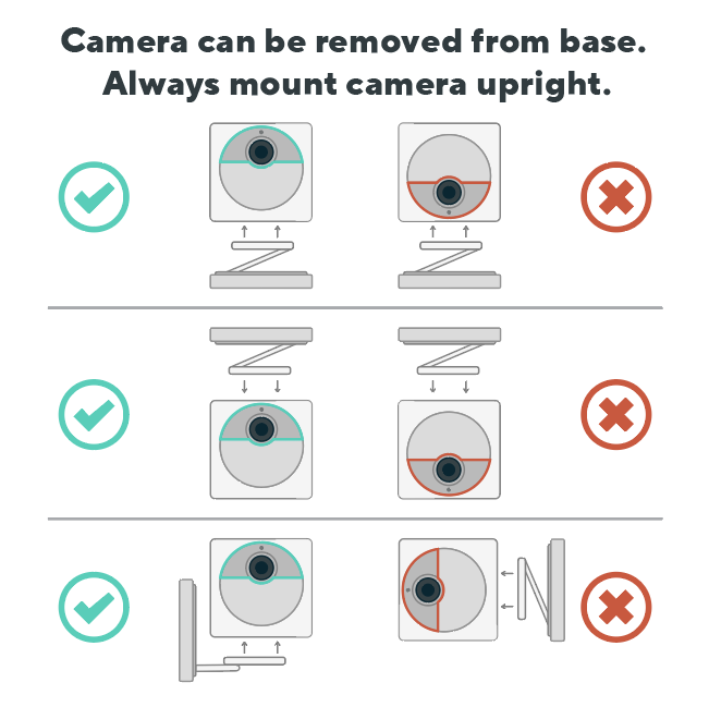

To mount your Wyze Cam Outdoor to a ceiling:
  1. Position your Wyze Cam Outdoor on the ceiling where you want to mount it.
  2. Drill a 3mm hole in that spot, and insert the included Drywall Anchor.
  3. Screw the base of the Wyze Cam Outdoor into the Drywall Anchor using the hole labeled "Ceiling Mount".
  4. Attach the top of Wyze Cam Outdoor to the magnetic base.
    • Proper orientation: SYNC button facing down.

To mount your Wyze Cam Outdoor to a wall:
  1. Position your Wyze Cam Outdoor on the wall where you want to mount it.
  3. Screw the base of the Wyze Cam Outdoor into the Drywall Anchor using the hole labeled "Wall Mount".
  4. Attach the bottom of Wyze Cam Outdoor to the magnetic base to keep it in the proper orientation.

  • Always mount your Wyze Cam Outdoor right-side pointing up, with the SYNC button pointed down. Person detection may not work as accurately if the sensor is upside down.
