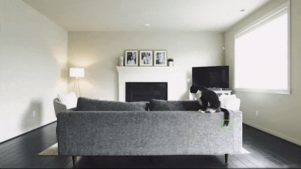

Motion Tagging shows a green box around objects in motion. This helps when scrolling through a lot of footage to see if and where motion happened.
Here's a clip of what Motion Tagging looks like:

  • When Motion Tagging is turned on, it will be visible in ANY recorded video (Playback, Event Videos, Time Lapse, and Manually Recorded Videos).
  • Motion Tagging sensitivity is fixed, and predefined. This means that it is not affected by changes to your Detection Settings.
  • If there are multiple moving objects in view, the largest moving object will be framed.
  • If the green frame touches the Detection Zone, even if the object doesn't enter the zone, it will be tagged as motion.
