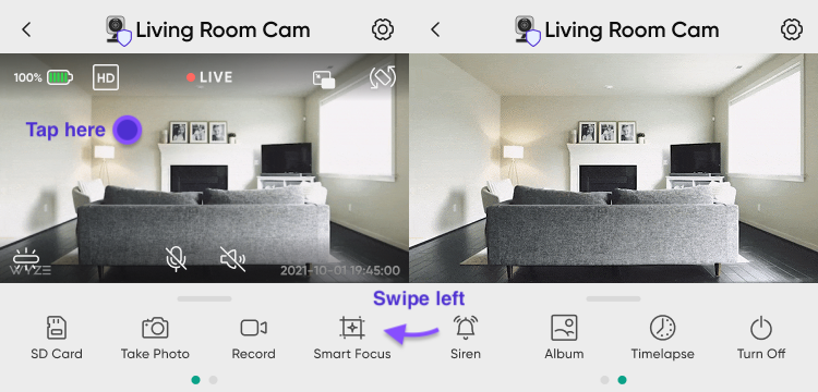

Live Stream Icons:
Tap on the Live stream to display the icons.
  • Streaming Quality: Change the streaming quality of your Live stream with just a tap.
    • Depending on your Wyze Cam, you may any of these settings: 4K, 2.5K, 2K, HD, SD, or 360p.
    • Having connection issues? Set your quality to SD or 360p to use less bandwidth.
  • Battery Percentage: Displays on the Live stream for all battery-powered Wyze Cams.
  • Picture-in-Picture (PIP): Opens a moveable pop-out window of the Live stream so you can navigate away from the Wyze app, while keeping the Live stream open.
  • Rotate/Fullscreen: Rotates the Live stream to a fullscreen landscape view.
  • Spotlight: Displays the status of the built-in spotlight, or turns it on/off.
    • Available on select Wyze Cams.
  • Speak: Tap to send your voice through the camera's speaker.  When finished speaking, tap the microphone icon again.
  • Sound: Listen to audio the camera’s microphone.
Swipe left on the Menu bar to view all icons.
  • SD Card: With a microSD card installed, view playback and filter local recordings.
  • Take Photo: Take a picture of the stream from the Live Stream screen.
  • Record: Record a video of the stream directly from the Live stream screen.
  • Smart Focus: An auto-zoomed view to focus on what matters, with an overlay of the full view.
  • Siren: Careful! A loud alarm will sound when tapped. Tap again to turn off the siren.
  • Album: All videos and photos saved to the device from this camera will display here.
  • Timelapse: Set a timelapse recording on your camera.
  • Turn Off: Turns off your Wyze Cam. The camera still has power, but the Live stream is off, the camera will not record events, and all other functions are disabled.
    • Tap Turn On to turn your Wyze Cam on.
  • Reorder: Customize the order of the Menu bar options.

From the Live stream:
  1. In the Wyze app, go to the Home tab.
  2. Tap your Wyze Cam on the Favorites or Devices tab.
  3. Swipe left on the Menu bar, then tap Turn Off.

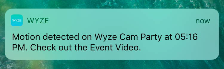

From a Push Notification:
  1. From your mobile device, tap on the push notification that you received.
    • You'll only receive a notification if you have push notifications enabled for Event videos.
  2. This will open the Wyze app and take you directly to the Event video.

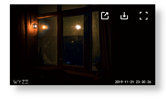

Event videos don't have to stay in the cloud! You can save and share individual videos with a few taps.
To save an Event video:
  1. In the Wyze app, go to the Events tab.
  2. Tap on the video you want to save.
  3. Tap on the video to display the side menu, then tap More.
  4. Tap Download to save the Event to you device.
To share an Event video:
  4. Tap the Share share icon to bring up the Share menu.
