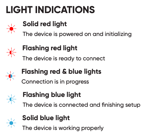

Status light: What does the light mean?
Solid red light
Camera is powered and starting up
Watching live stream
Recording Event video
Flashing red light
Camera is powered and ready to connect to Wi-Fi
Siren is sounding (quick flashing red light)
Or, possible error state:
QR code incorrect
Connection timed out, cannot connect to network
Network encryption method not supported
Flashing red and blue lights
Camera is trying to connect to Wi-Fi
Scanning QR code
Upgrading with a microSD card
Network disconnected
Flashing blue light
Camera is connected, still finishing setup
Firmware update (quick flashing blue light)
Disconnected from external/network server
Solid blue light
Camera is powered, connected, and working properly
Here's how Wyze Cam v3's status light guide looks in the Quick Start Guide:
Wyze Cam v3 Status Light guide
