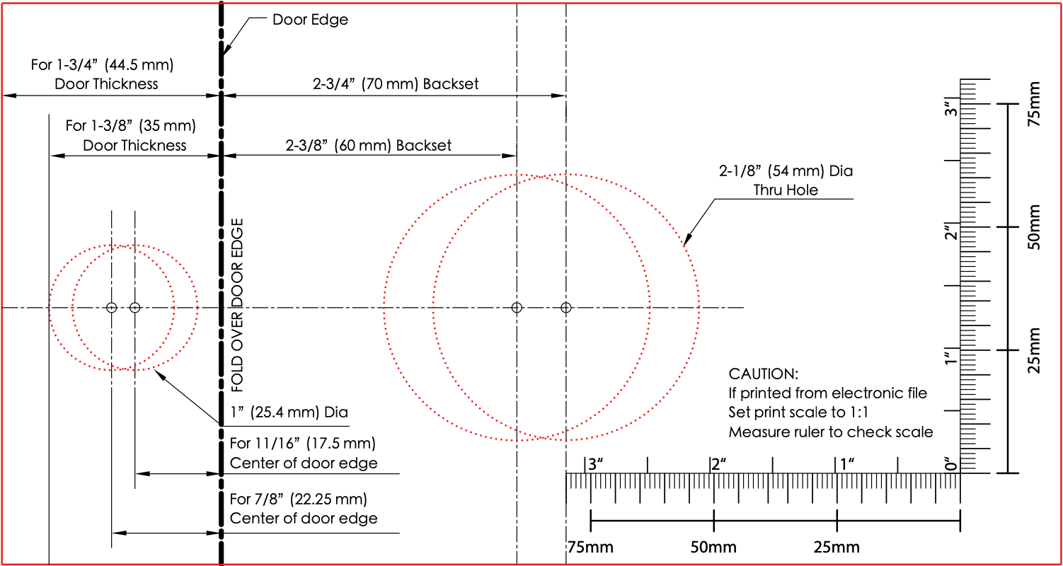

After you remove your existing lock, you will line up the template to check your backset and ensure the lock is compatible without any adjustments. If it is not, follow along in the installation guide video to get it lined up.
Is my door thick enough for Wyze Palm Lock?
Your door must be between 35mm-55mm in thickness to use Wyze Palm Lock. If your door is thinner than 35mm, we do not recommend installing this lock as it may not function properly.

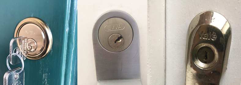

  • Mortise or Integrated Lock & Handles
  • Rim Cylinder (you will need a circular saw or spade bit to expand the main hole on the door)

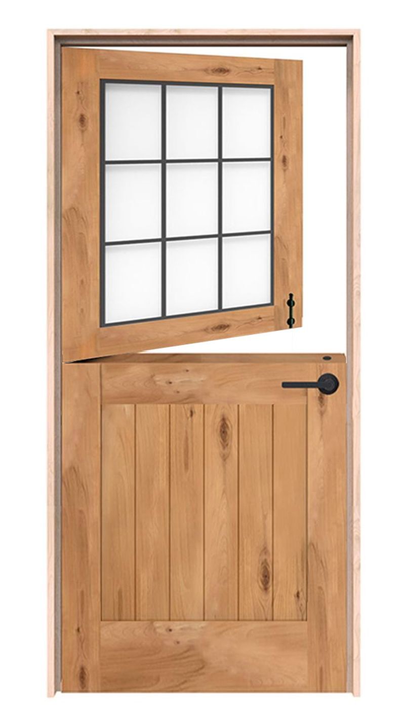

  • Dutch doors (doors that open at the top and bottom)
