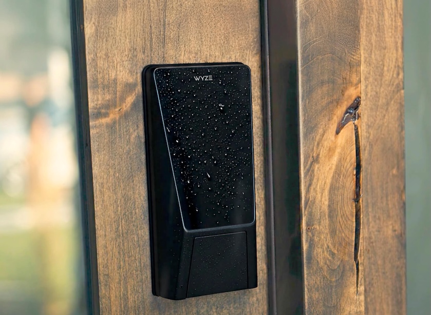

Storm doors are not recommended with Wyze Palm Lock because they can cause the lock to wake excessively due to motion. Even minor motion, like wind blowing, can shift the door and wake up your Wyze Palm Lock - even hundreds of times per day.
This motion will drain the battery rapidly.
