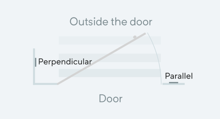

Select where your doorbell will be mounted, relative to the door. Tap Next.
- Perpendicular
- Parallel.

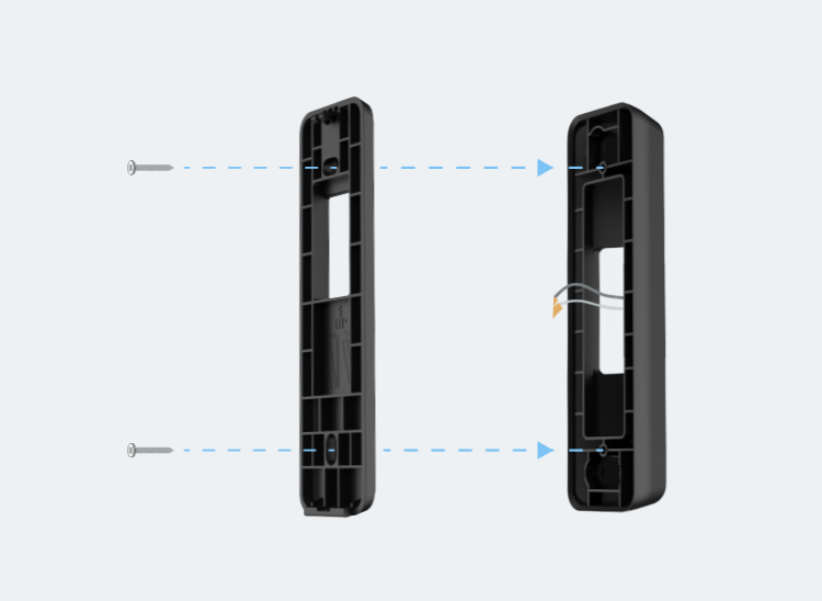

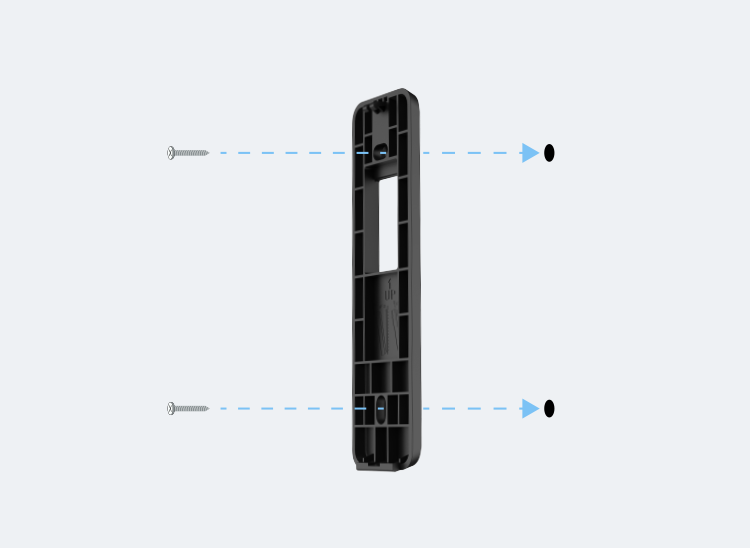

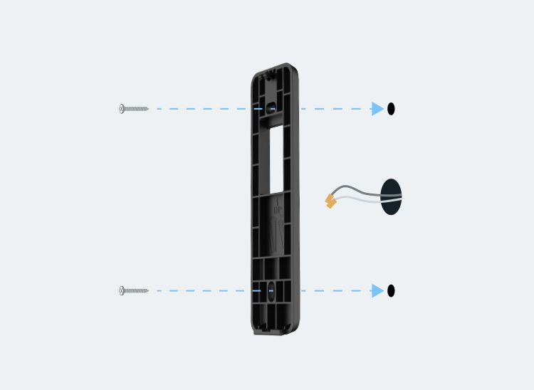

- Follow the steps to mount the Back Plate.
- At an angle
- Follow the steps to mount the Corner Kit, then Back Plate.

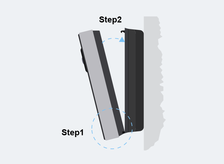

- Attach your doorbell to the Back Plate starting from the bottom, as shown in the app. Tap Next.

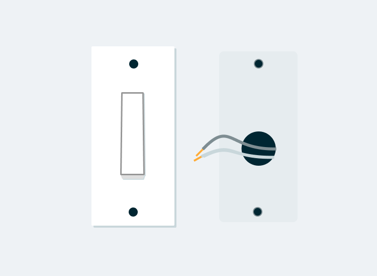

- Turn off power to your current mechanical doorbell at your electrical panel. Tap Next.
- Related article: Which switch in the electrical panel controls my doorbell?
- Press your doorbell button to confirm the power is shut off.
Gently remove your existing doorbell and disconnect the wires. Tap Next.

- Straight ahead
- At an angle

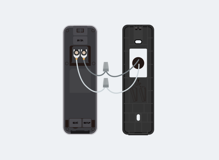

- Attach the extension wires to your new doorbell, following along in the app. Tap Next.
Pair and cap the loose extension wire ends with the wires from the wall. Tap Next.
- Attach your doorbell to the backplate starting from the bottom, as shown in the app. Tap Next.
