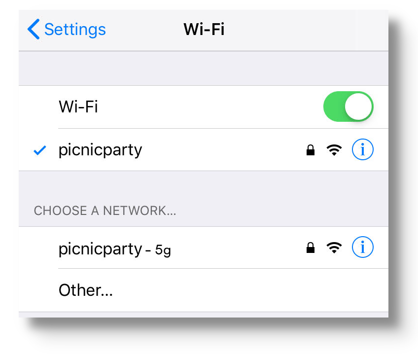

How many Wi-Fi networks do you see that belong to you?
  • I see ONE network: If you only see one Wi-Fi network name that belongs to you, it should be a 2.4 GHz network and will work with Wyze Devices.
  • I see TWO or more networks: If you see two or more Wi-Fi network names that belong to you, then you probably have a 2.4 GHz and 5 GHz dual-band router. If so, from your smartphone's Wireless settings page, look at the names of your Wi-Fi networks.
    • 2.4 GHz network may have "24G," "2.4," or "24" appended to the end of the network name. Or it might not have anything at all after the name.
    • A 5 GHz network may have "5G," "5g," 5GHz," or "5" appended to the end of the network name, for example "MyWirelessNetwork - 5g"
    • When setting up your Wyze Device, connect to the 2.4GHz band.
Make sure the network you pick does not have "5G," "5g," 5GHz," or "5" at the end.
