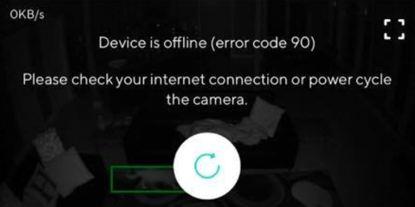

I get "Device is offline (error code 90)" in the app for Wyze Cam Pan.
Problem
When accessing your Wyze Cam Pan v2 in the Wyze app, this message displays:
"Device is offline (error code 90). Please check your internet connection or power cycle the camera."
Error code 90 may appear...
  • On the live stream for any Wyze Cam.
  • When you've just finished setting up a Wyze Cam in the Wyze app.
  • If you try to access your camera in the app after it's been set up.
  • After basic troubleshooting (restarting the device, rebooting your router). It appears to connect to the live stream, then the error appears shortly after.
