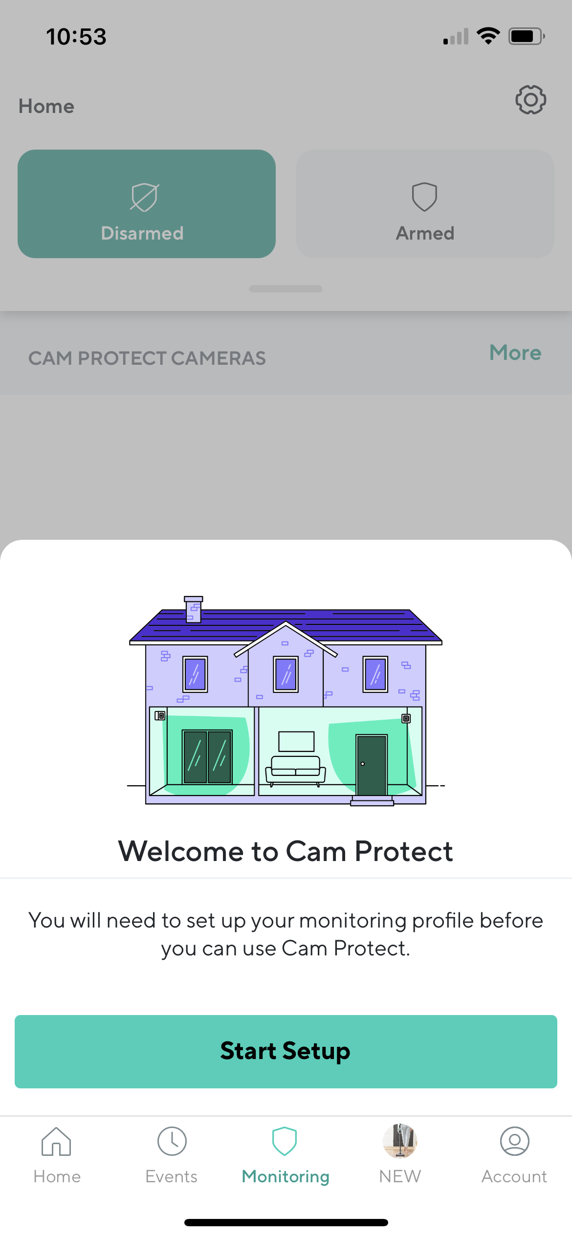

  1. Navigate to the Wyze App > Monitoring Tab.
  2. You will be able to see Start Setup
  3. Click Start Setup.

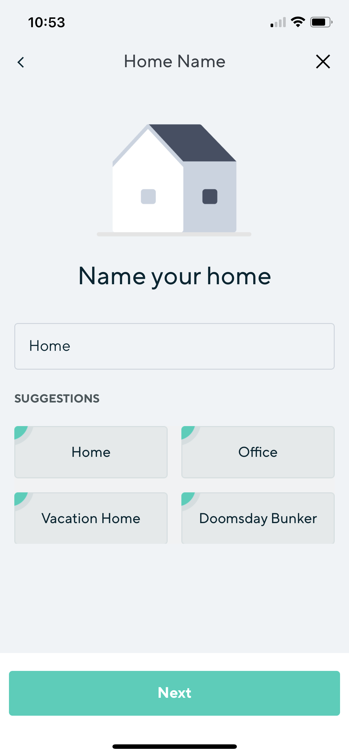

  5. Once this step is complete, Please Name your Home.

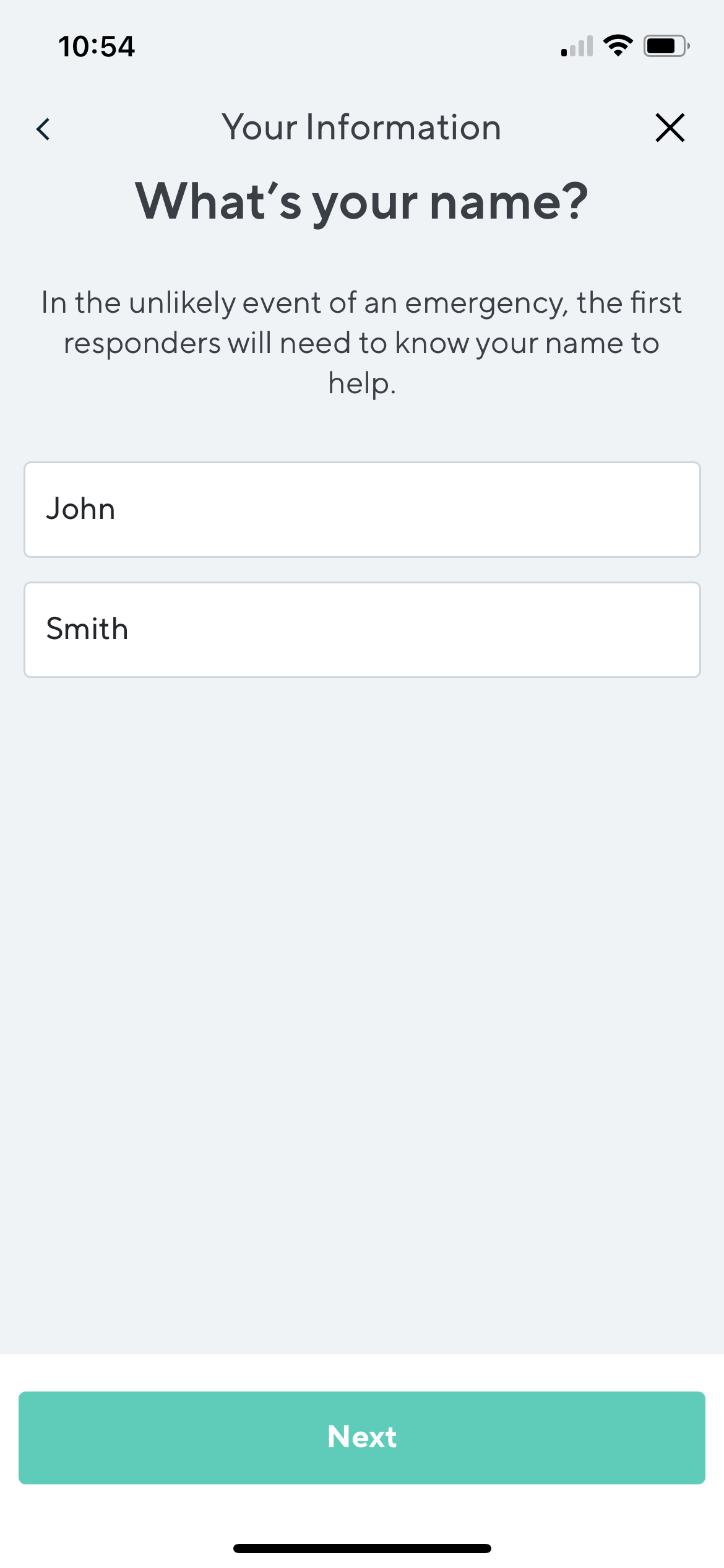

  6. The Next Step is to Enter your Personal Information.
  7. Enter your First and Last Name
  8. Enter your Phone Number .

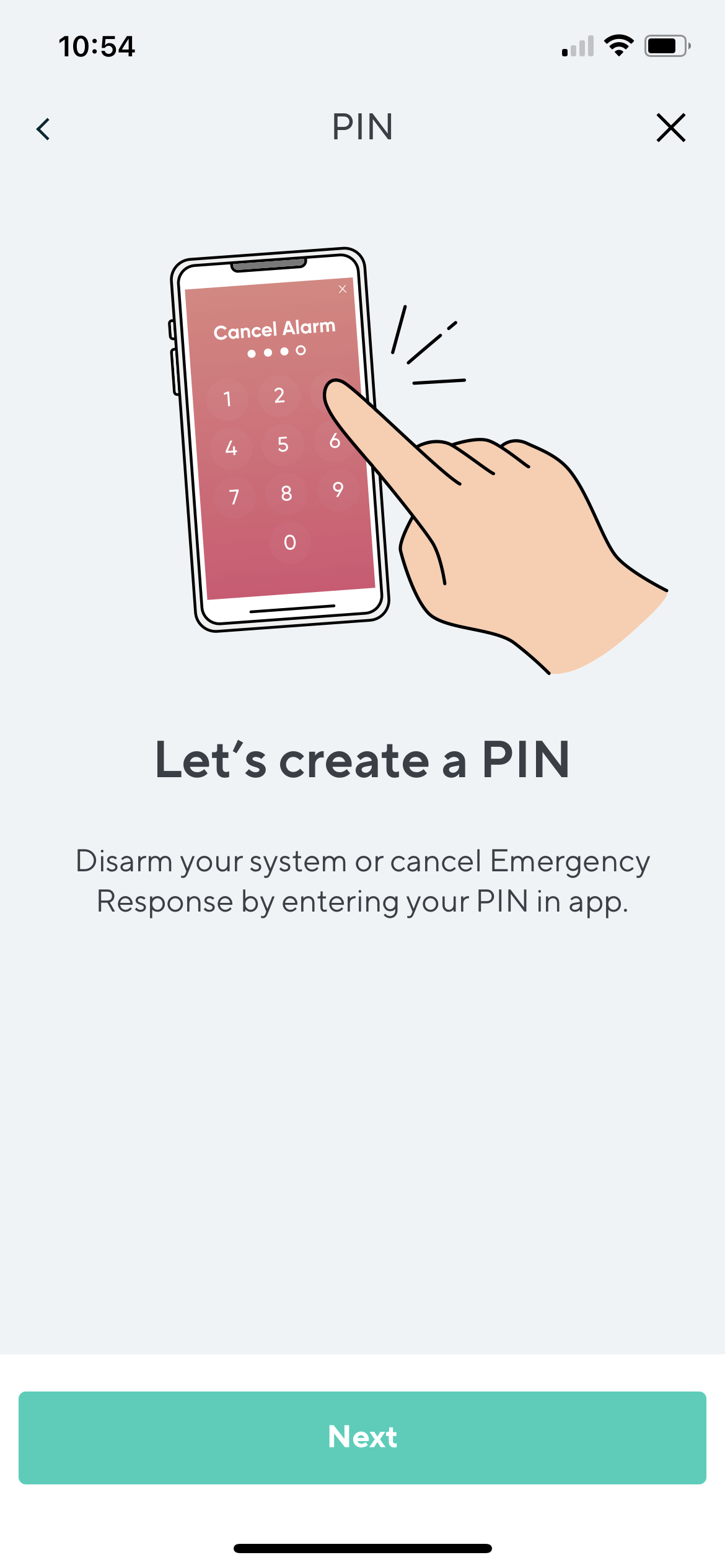

  • Setting up Pin and Safe Word:
  1.  After Completing the Verification for the Phone Number, The next step is to set up the PIN and Safe Word.
  2. The App will ask you to create a PIN that can be used for Arming and Disarming the Cameras.

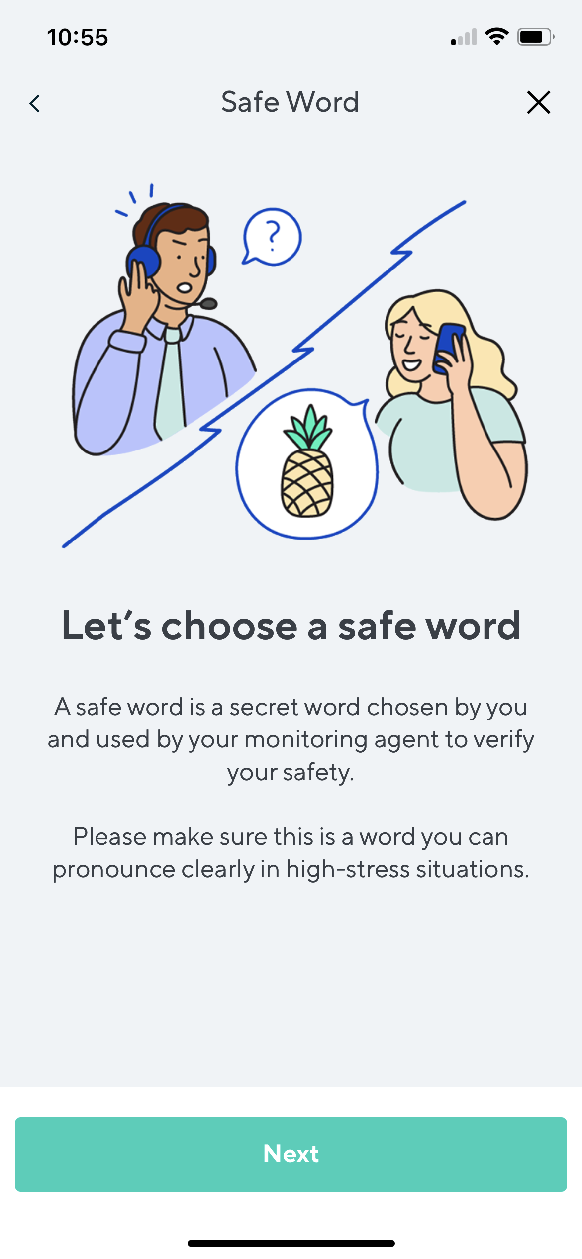

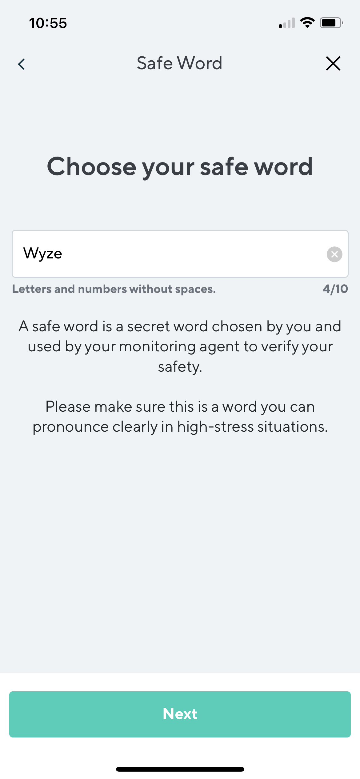

  3. The next step is to Create a Safe Word that can be shared with the Noonlight Agents to ensure Safety and cancel Alarms.

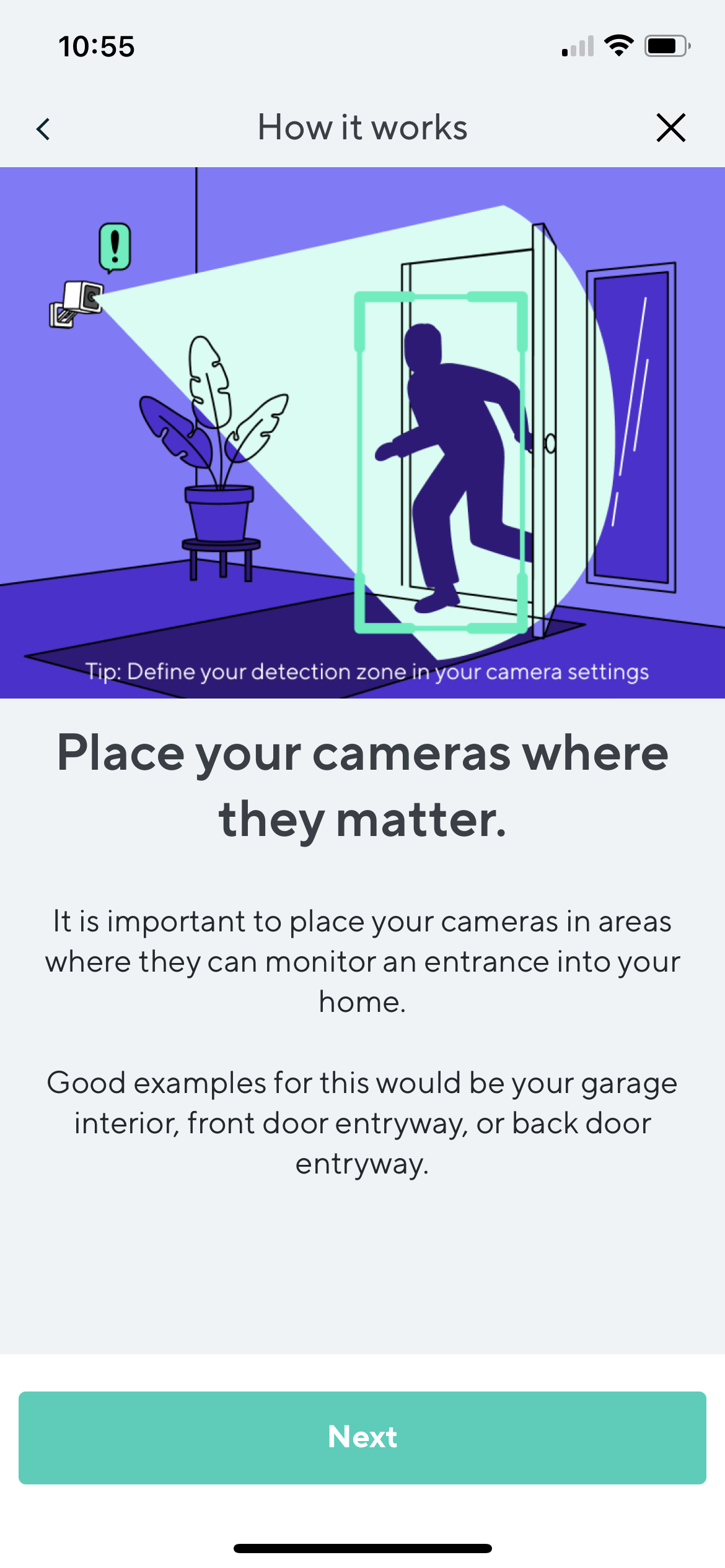

  • Setting up Cameras
  1. After Setting up the Pin and Safe Word, the Next Step is to set up your cameras.
  2. Place the Cameras in areas inside your home where you would like to be alerted if a Person is detected.
  3. Follow the Tips in the App for avoiding False Alarms

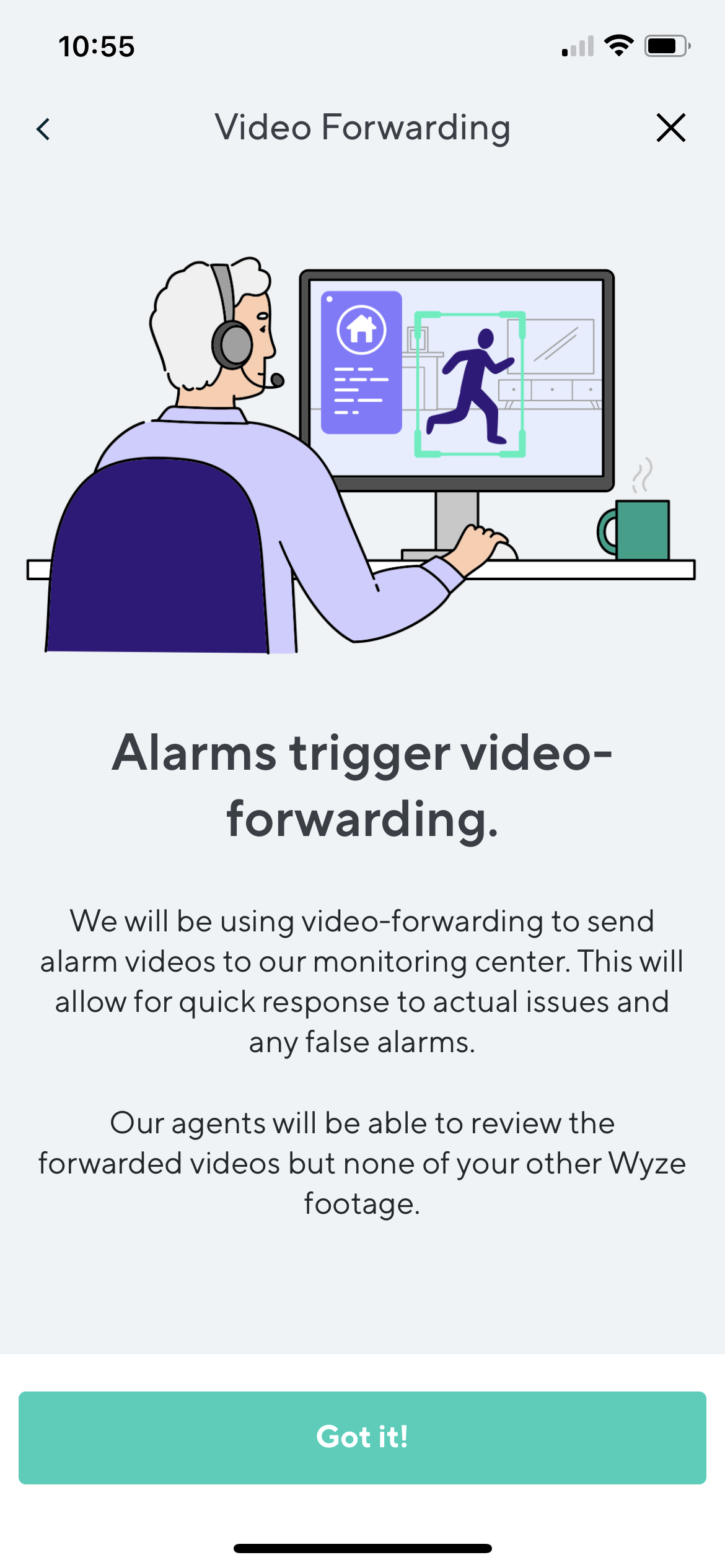

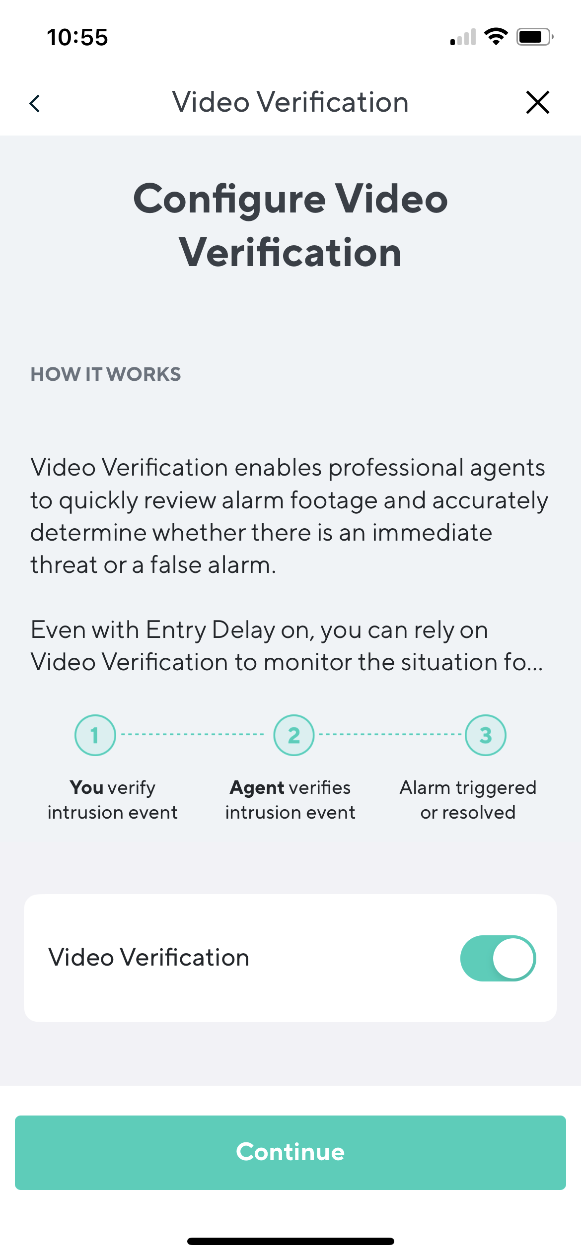

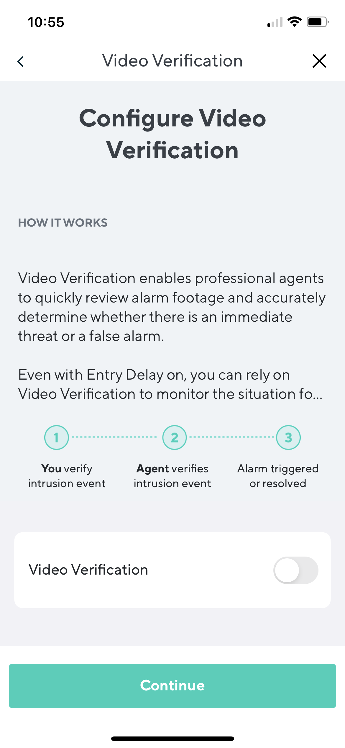

  • Setting up Video Verification
  1. Video Verification is a feature with Cam Protect to avoid false alarms and false dispatch for Emergency Services.
  2. You can enable Video Verify during setup or later on from Cam Protect Settings.

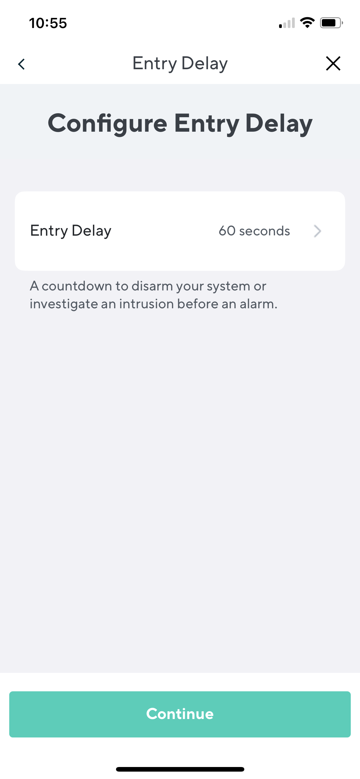

  • Setting up Entry Delay
  1. Entry delays can be used to delay the Alarm by a few seconds.
  2. Cam Protect allows Entry Delays from 0 sec to 60 sec.

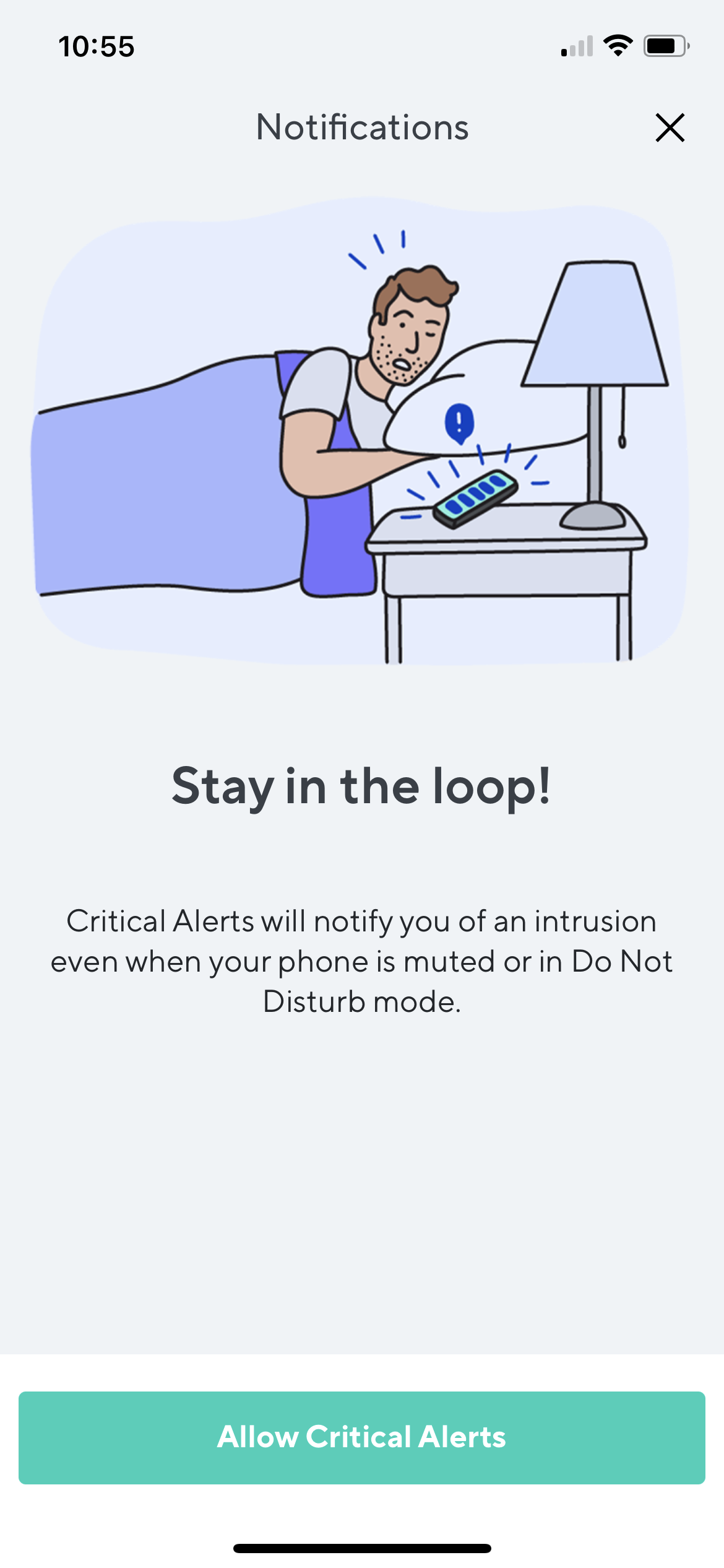

  • Setup Alert Types
Critical Alerts ( IOS only) will allow you to receive notifications even if your phone is on Do not Disturb Mode.

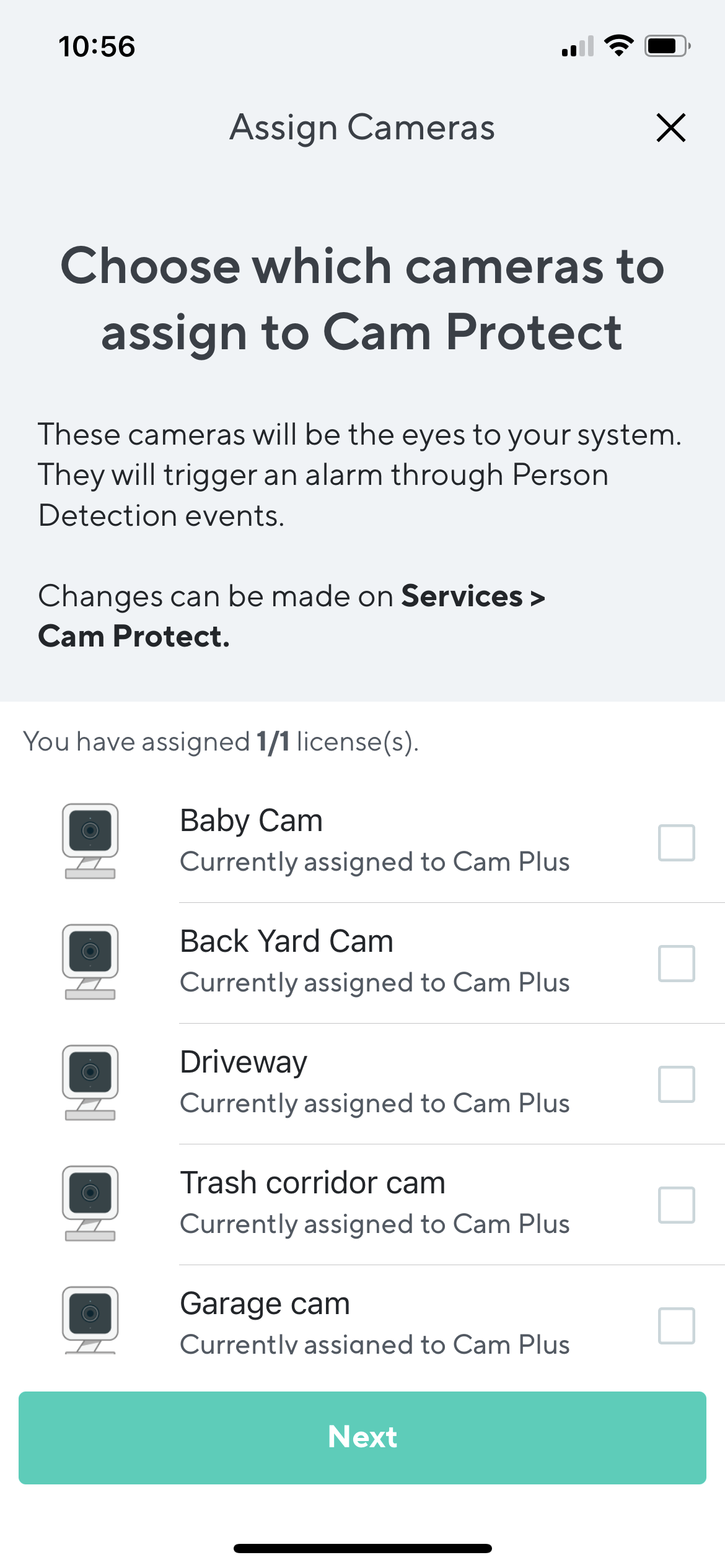

3. Assign your cameras and Settings.
  1. Assign the cameras from the list of available cameras.

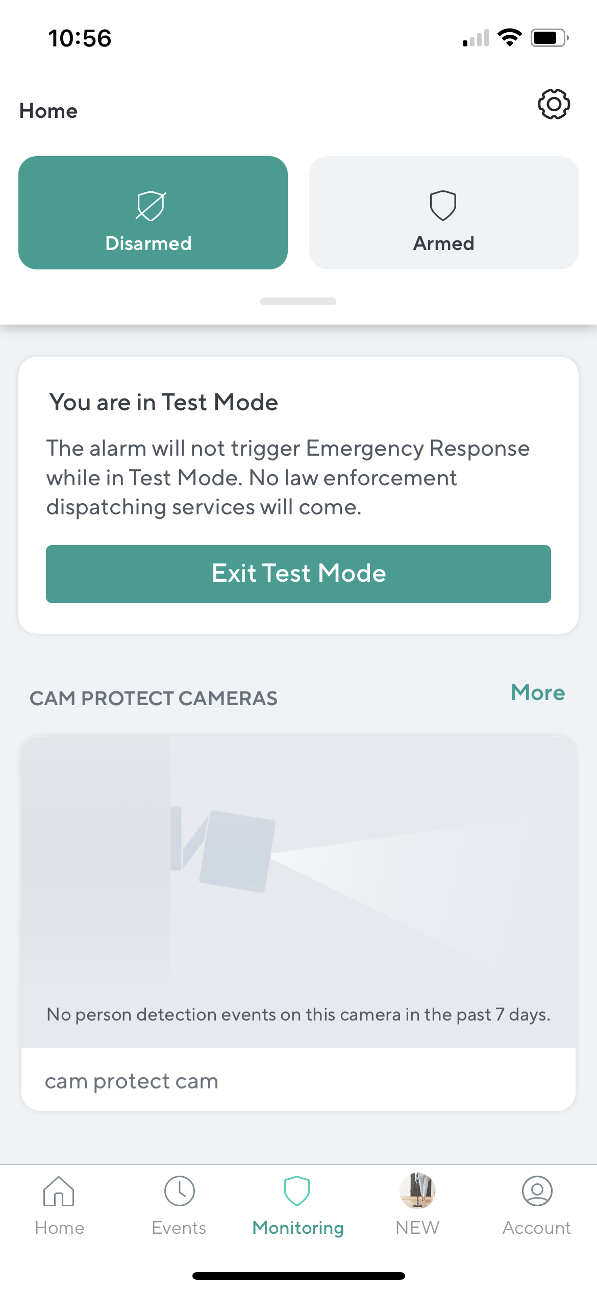

  • Test Mode
By default the System will be in Test Mode. The Emergency Services are not triggered in Test Mode.

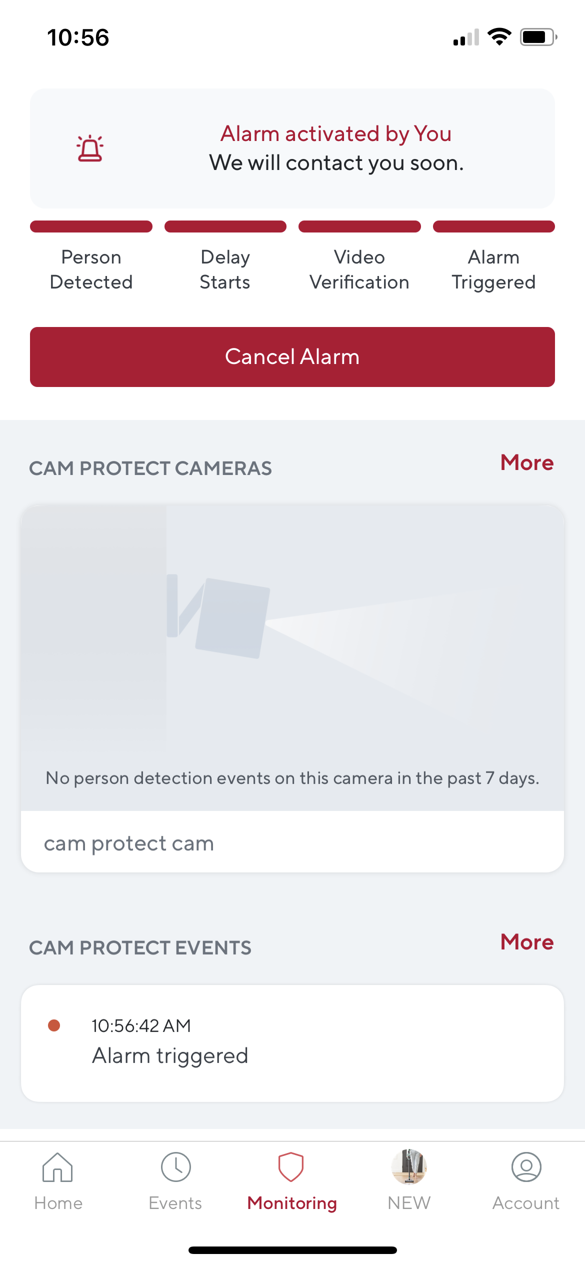

  • Request Dispatch
You can press and hold the Request dispatch button to trigger an alarm.

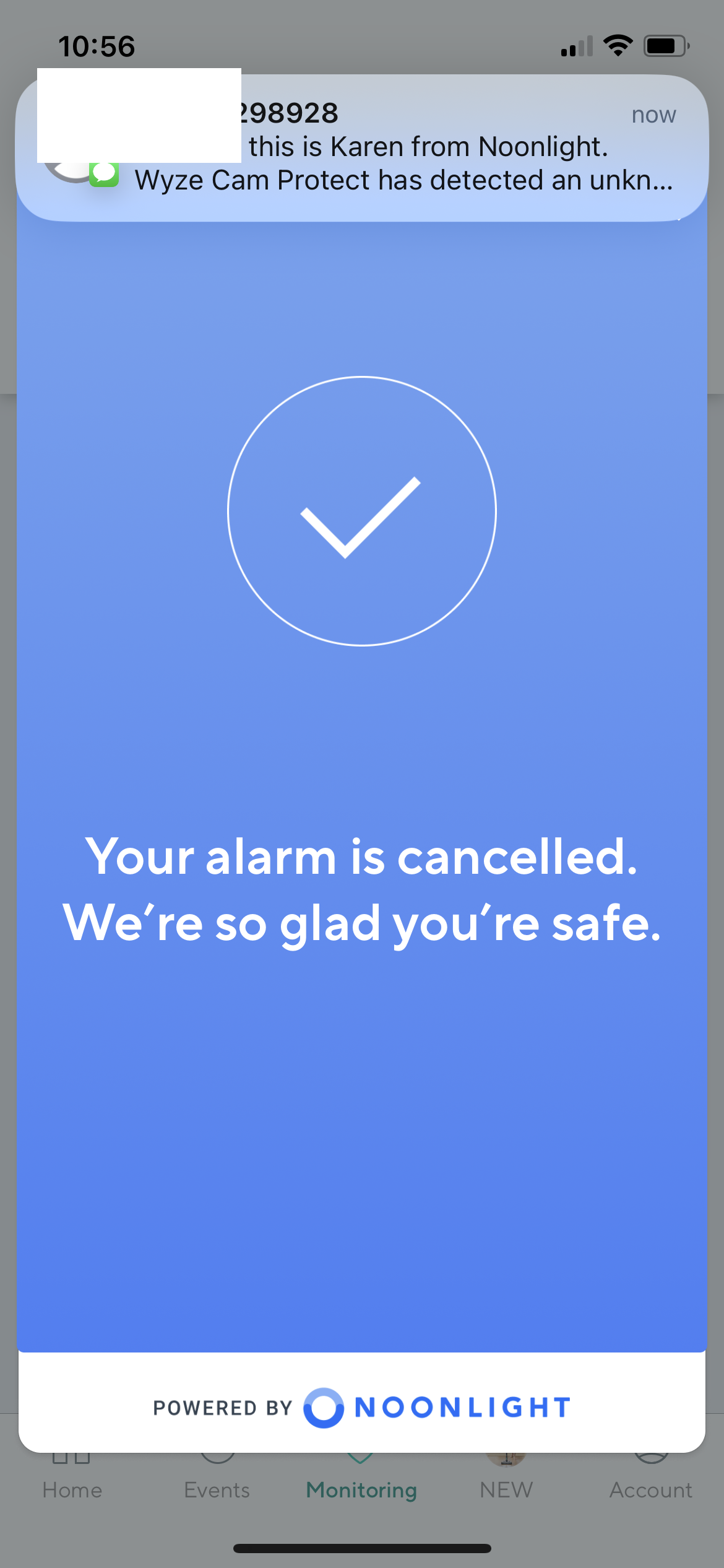

Once the Alarm is triggered, enter the pin to disarm or use the safe word with the Noonlight agent to cancel the alarm.

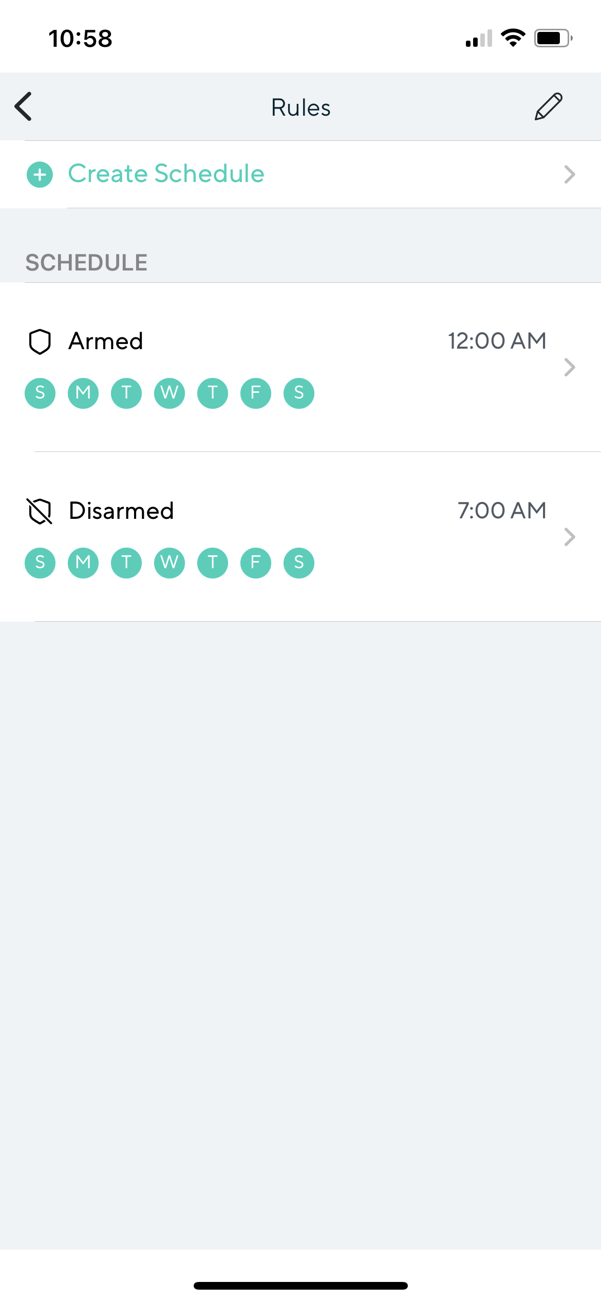

  • Settings Up Rules and Schedules.
This feature allows you to setup your schedules for arming and disarming your cameras without having to manually change the state every time.
