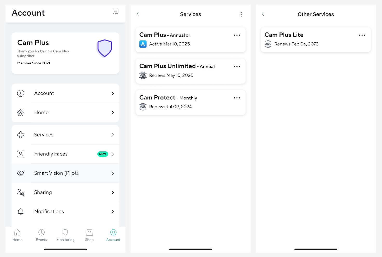

To assign Cam Plus Lite to your camera:
  1. In the Wyze app, tap Account > Services.
  2. Tap the three dots menu on the top right of the screen.
  3. Tap the three dots next to Cam Plus Lite.
  4. Tap Manage Camera.*
  5. Tap on the camera(s) you want to assign Cam Plus Lite to. That's it!
