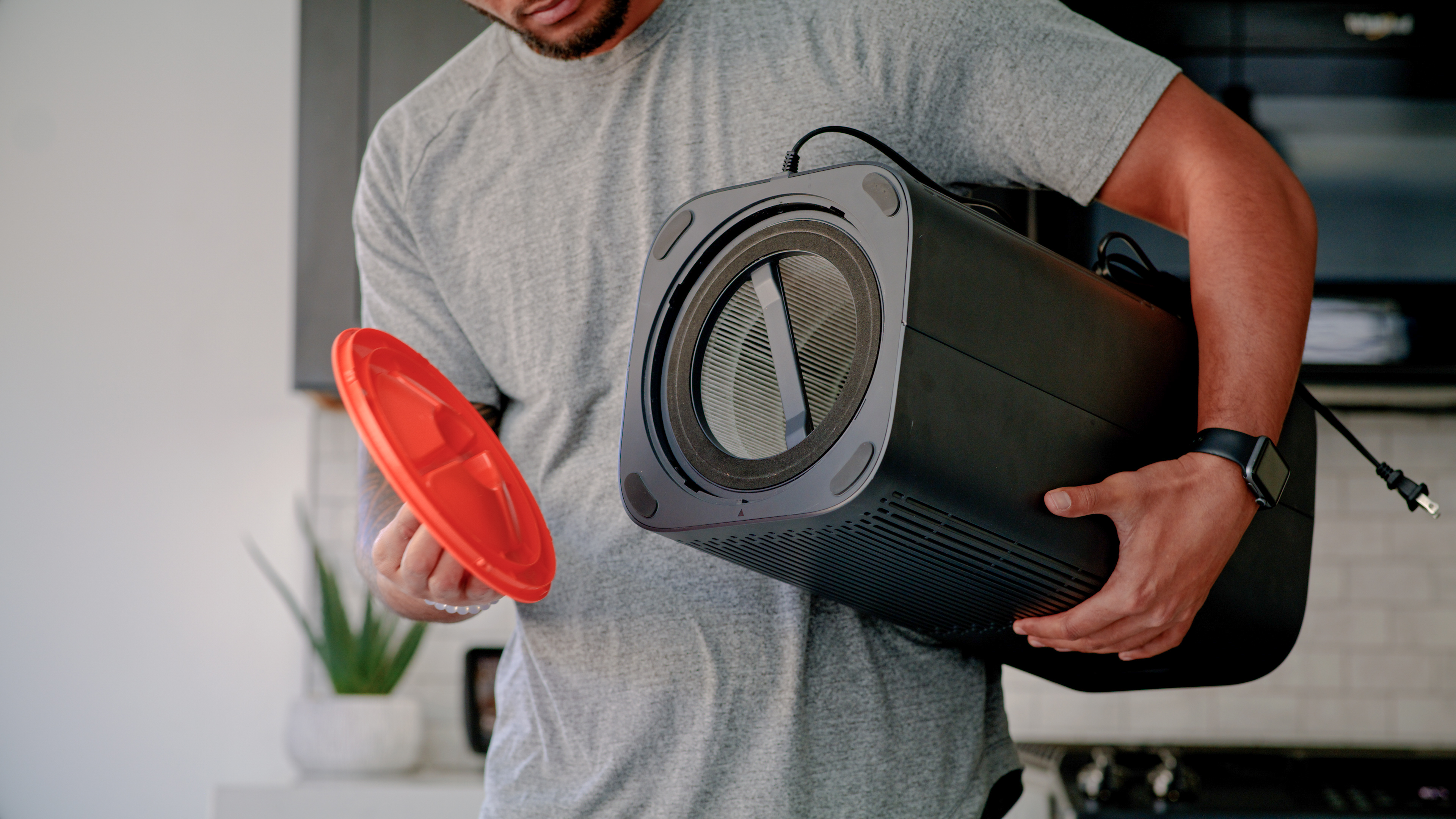

  1. Remove the air purifier from the packaging.
  2. Turn the air purifier over to locate the orange filter cover. Rotate and remove the cover.
  3. Take out the pre-installed filter and remove the plastic packaging.
    • You must remove all packaging and wrapping before proceeding.
  4. Re-install the now plastic-free filter into the air purifier.
  5. Put the filter cover back in place and rotate to close.
