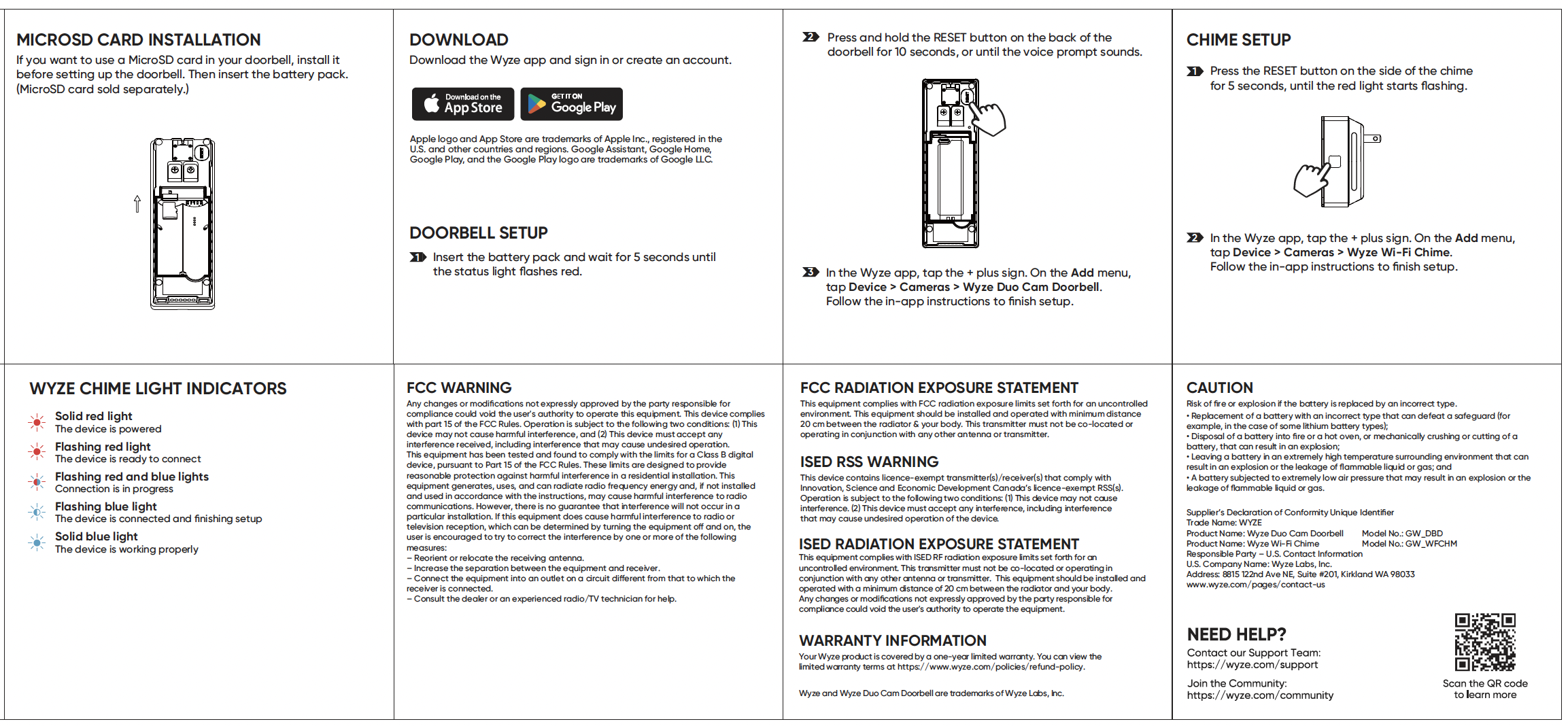

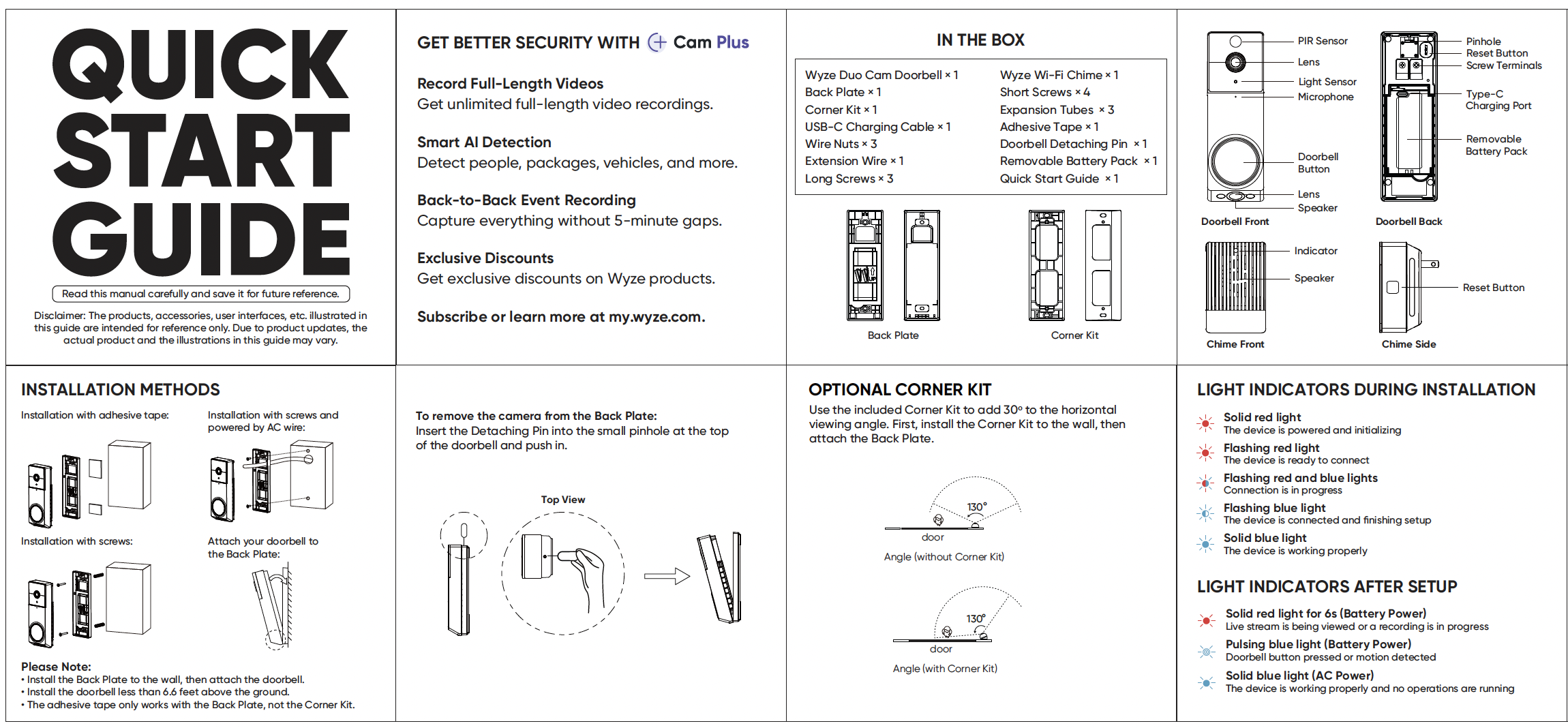

Download the Quick Start Guide for Wyze Duo Cam Doorbell in this article.
Below is the Quick Start Guide for Wyze Duo Cam Doorbell, a short manual for how to get started.
This guide is a short user manual with the basics about Wyze Duo Cam Doorbell, including:
  • What's in the box for Wyze Duo Cam Doorbell.
  • A diagram of Wyze Duo Cam Doorbell and Wyze Wi-Fi Chime..
  • How to set up Wyze Duo Cam Doorbell and Wyze Wi-Fi Chime.
  • How to install Wyze Duo Cam Doorbell and Wyze Wi-Fi Chime.
