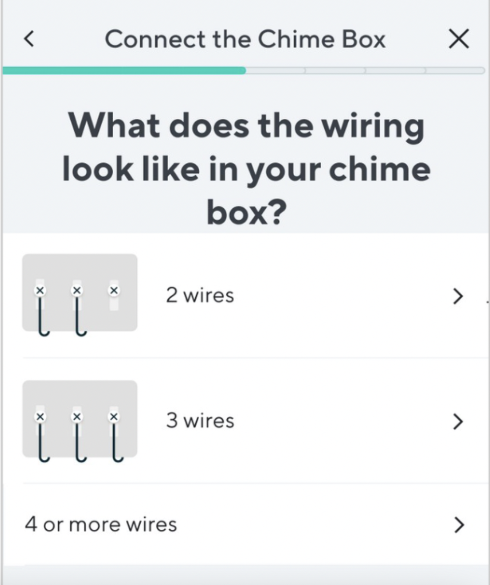

  6. Select the option in the Wyze app that best matches your chime's wiring setup and follow along in the app to connect the wires to the correct terminals.

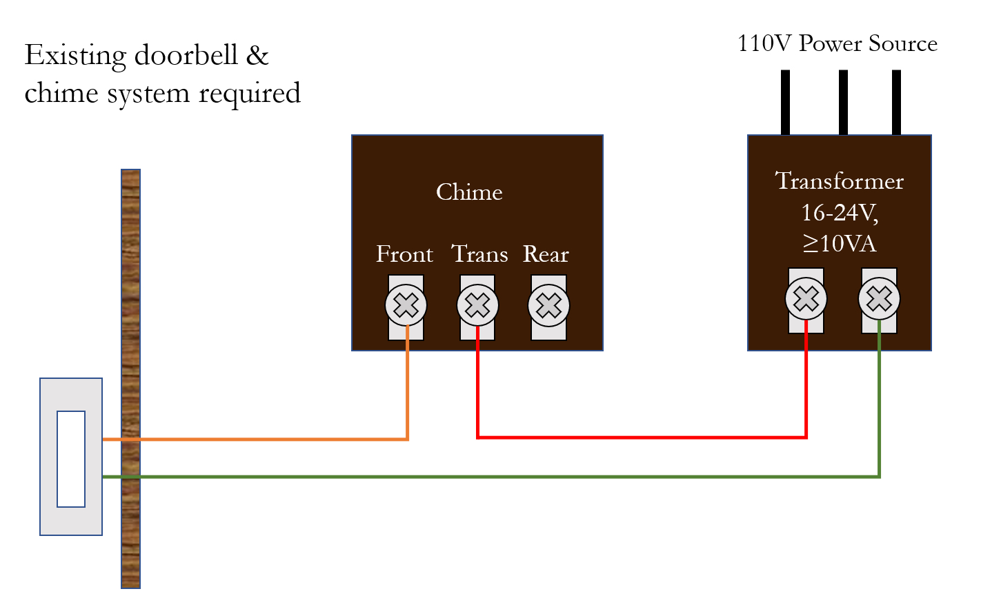

    Typically, homes with 1 doorbell have 2 wires, homes with 2 doorbells have 3 wires, etc.
    1. If you have 2 wires, follow the instructions to connect to the jump wire.
      • See the Before and After Installation graphics below for reference.
    2. If you have 3 wires, follow the instructions to select the correct door, and connect the proper wires.
    3. If you have 4 or more wires, follow the instructions to find the proper wires to connect.
      • This will involve some trial and error. If you are not comfortable testing your electrical panel, stop. Call your local electrician for help.
