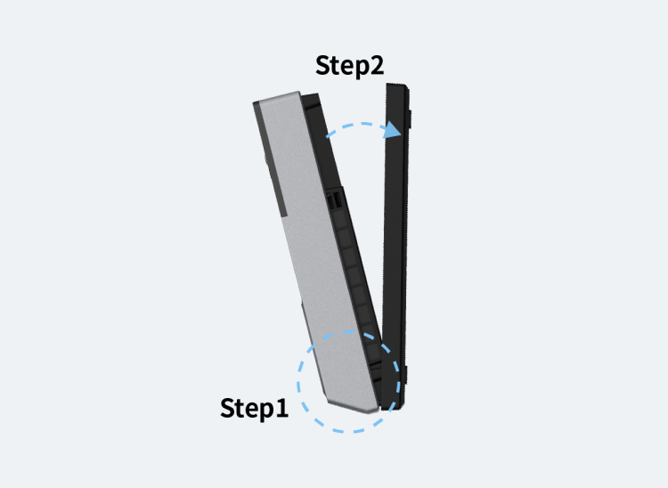

Use 3M if you don't want to drill any holes.
  1. Remove the adhesive backing from the back plate, then stick the back plate to the wall.
  2. With the battery installed, mount it to the back plate. Start from the bottom up!
    • If you place it from the top first, use the Doorbell Detaching Pin to remove it and try again.
  3. You're all set!

  12. Mount your doorbell to the back plate. Start from the bottom up!
