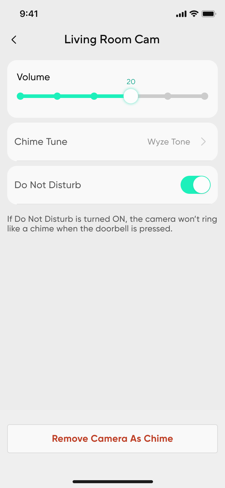

To manage your Camera as Chime settings:
  1. Go to the Cameras as Chimes screen, then tap on your camera.
    1. Go to Doorbell Settings > Chime > Cameras as chimes.
  2. Here, you can control the Volume, Chime Tune, and the Do Not Disturb Settings.
  3. To remove your camera as a chime, tap Remove Camera As Chime.
