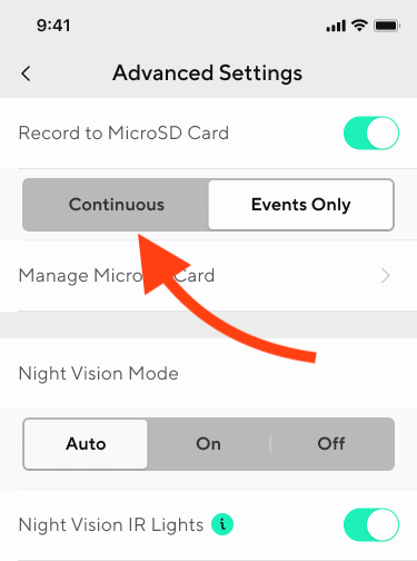

To enable Continuous recording on your doorbell
If your doorbell is already hardwired and you have a microSD card installed:
  1. In the Wyze app, tap on your Wyze Duo Cam Doorbell.
  2. Tap on the Settings gear, then Advanced Settings.
  3. Tap the toggle next to Record to microSD Card, then tap Continuous.

  7. In the Wyze app, tap on your Wyze Duo Cam Doorbell.
  8. Tap on the Settings gear, then Advanced Settings.
  9. Tap the toggle next to Record to microSD Card, then tap Continuous.
