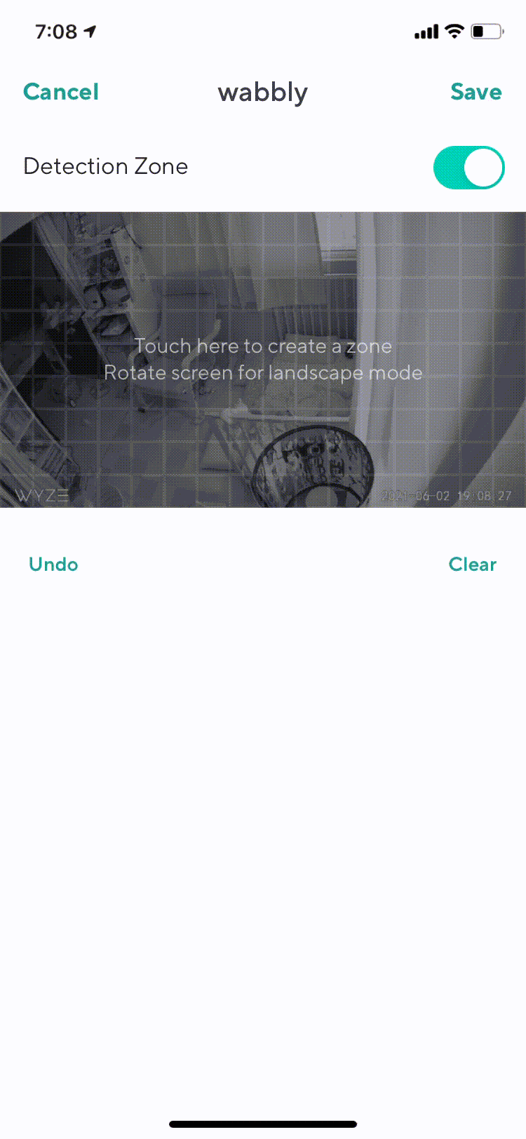

Detection Zones
The Detection Zone feature allows you to define a specific area that you want your Wyze Cam to detect motion in. Everything outside of the zone is ignored and will not trigger an Event Video (if Motion Detection is turned on) or Motion Tagging (if Motion Tracking is turned on).
You can use Detection Zones to exclude frequently or publicly accessed areas, like busy sidewalks or roads.
To set up a Detection Zone:
  1. In the Wyze app, tap on your Wyze Cam.
  2. Tap the Settings gear > Detection Settings > Detection Zone.
  3. Toggle Detection Zone On.
  4. With the Detection Zone on, draw on the grid to set your motion detection target area. The Detection Zone will be saved automatically.
