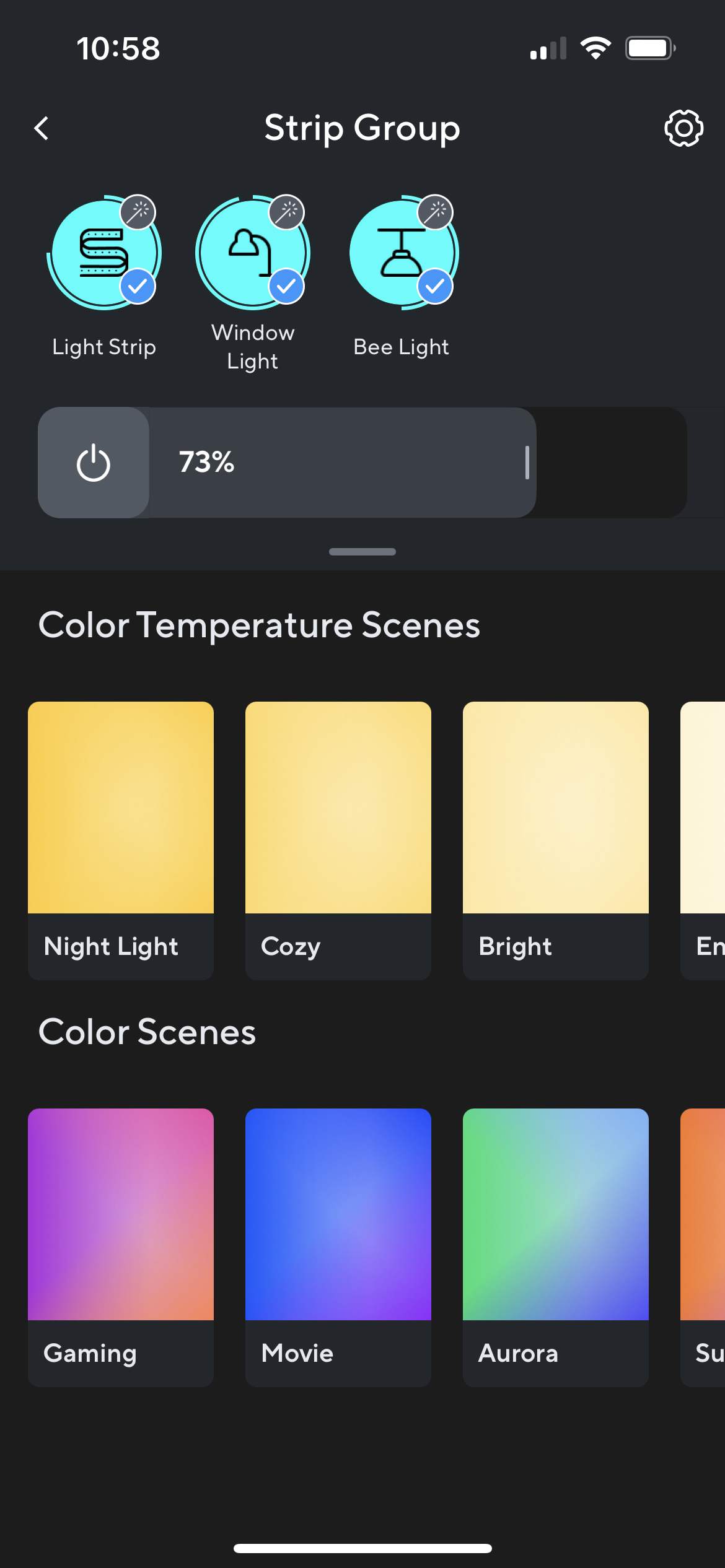

To use a default scene:
  1. In the Wyze app, tap on your Wyze Bulb Color.
  2. Scroll to Color Temperature Scenes or Color Scenes.
    How this looks in a group. You can set each device in a group to a different value.
  3. Tap the scene you want to use. The light will change automatically.
