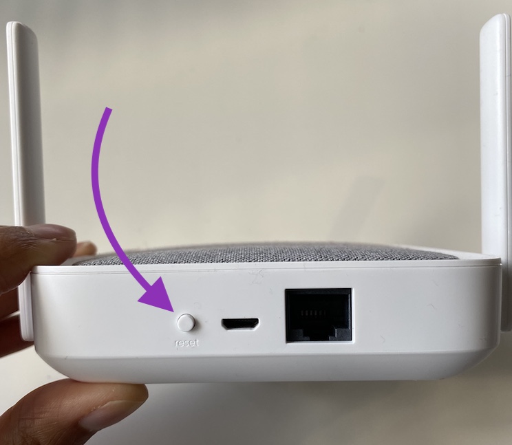

      1. On the back of your hub, single-press the reset button.
      2. Your Wyze Sense Hub will say "Ready to connect" and the status lights will flash.

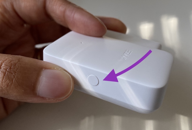

  2. Pull to remove the plastic battery tab from the sensor.
  3. Tap Next in the Wyze app.
    1. On the side of your Wyze Entry Sensor, press and hold the reset button until the status light flashes red.
    2. The Hub will say “Pairing successful” once complete.

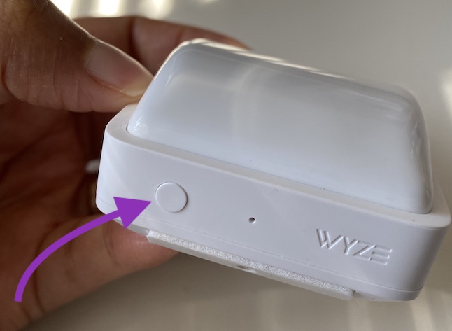

    1. On the side of your Wyze Motion Sensor, press and hold the reset button until the status light flashes red.
