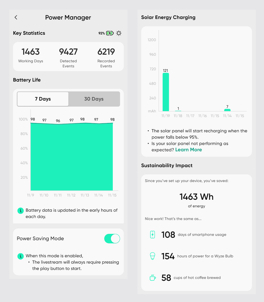

Your Wyze Solar Cam Pan comes with a Power Manager page in the Device Settings. This page provides power and charging statistics, and lets you enable Power Saving Mode.
Key Statistics
  • Working Days: Days your device has been set up.
  • Detected Events: The number of events your device has detected.
  • Recorded Events: the number of events your device has recorded.
Tip: If you divide the number of Detected Events by the number of Working Days, you'll get the average number of detections per day. If this is higher than 200 detections/day, we recommend adjusting your settings.
Battery Life
Updated daily to show the changes in battery charge percentage over the past 7 or 30 days.
Power Saving Mode
Helps maximize battery life. When enabled, you will always have to press the play button to view the livestream. The livestream will pause after 3 minutes of inactivity.
Solar Energy Charging
The amount of power provided (in mAh) by the solar panel to Wyze Solar Cam Pan. The solar panel will start recharging when the camera's power is <95%.
Sustainability Impact
The amount of energy you've saved (in Wh) by using the solar panel to charge the camera. Good on you!
