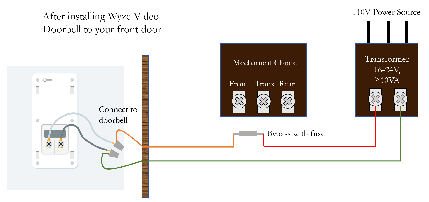

  4. Bypass the current chime circuit.
    1. If you have 2 wires, follow the instructions to connect to the jump wire.
    2. If you have 3 wires, follow the instructions to select the correct door, and connect the proper wires.
    3. If you have 4 or more wires, follow the instructions to find the proper wires to connect.

  12. Connect the wires from your new doorbell to the wires in the wall.
    • Pair each end, twist them together, then cover and twist with the wire caps.
    • Tap Show Me How to use the Wire Cap to see a tutorial.

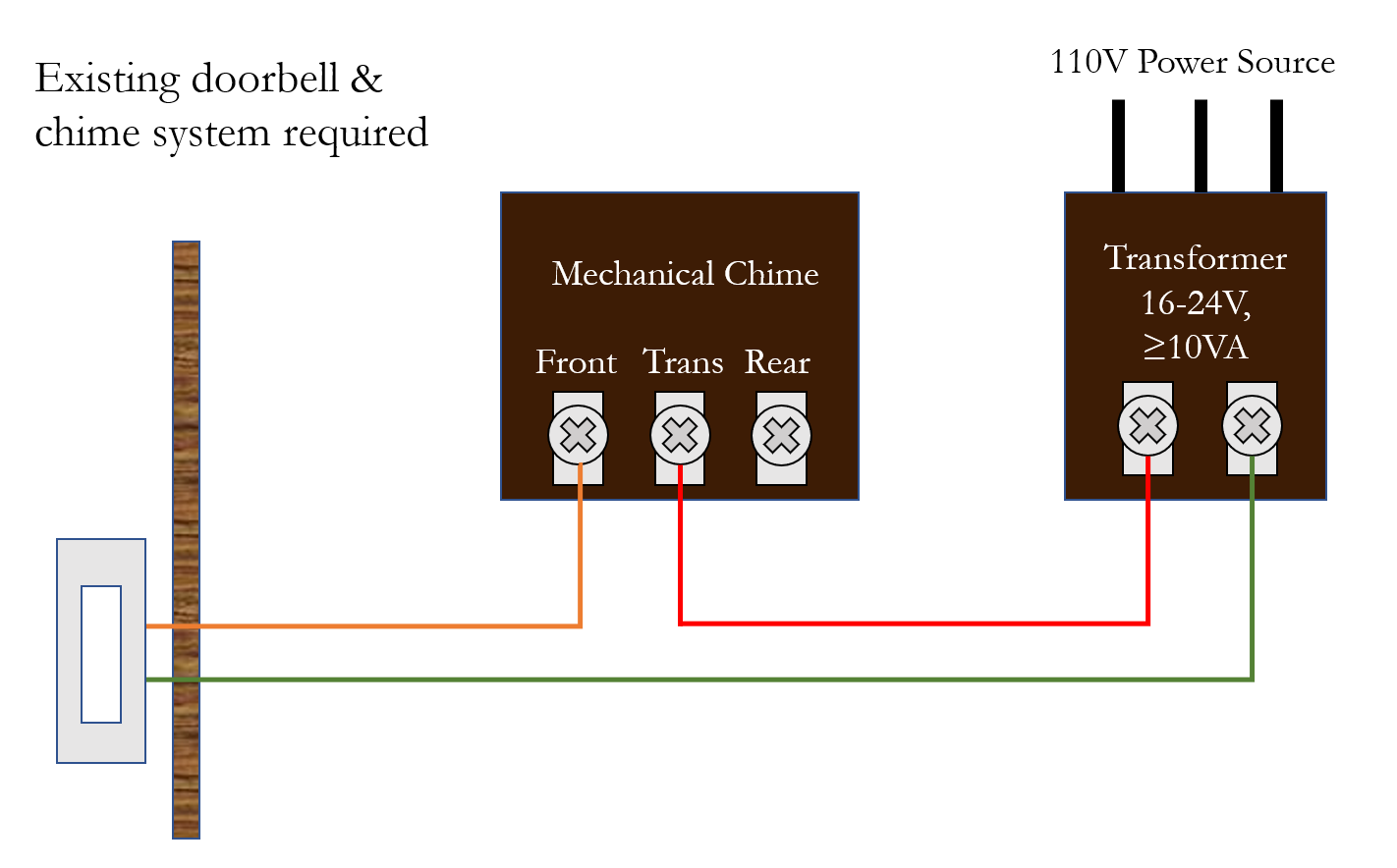

Before Installing Wyze Video Doorbell After Installing Wyze Video Doorbell
