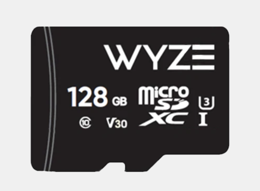

  1. Get a microSD card.
    Any microSD card will do, but we're partial to our Wyze 32GB MicroSDHC card available in the Wyze Shop. If you're using your own card, Wyze cameras are compatible with Class 10 cards in FAT32 and exFAT formats.
    • FAT32: Wyze Battery Cam Pro supports cards size ​​8 GB, 16 GB, and 32 GB.
    • exFAT: Wyze Battery Cam Pro supports cards size 64 GB, 128 GB, and 256 GB*.
    * We have tested with cards up to 256 GB when formatted as exFAT. Even larger cards may work, but this has not been tested on our end.
