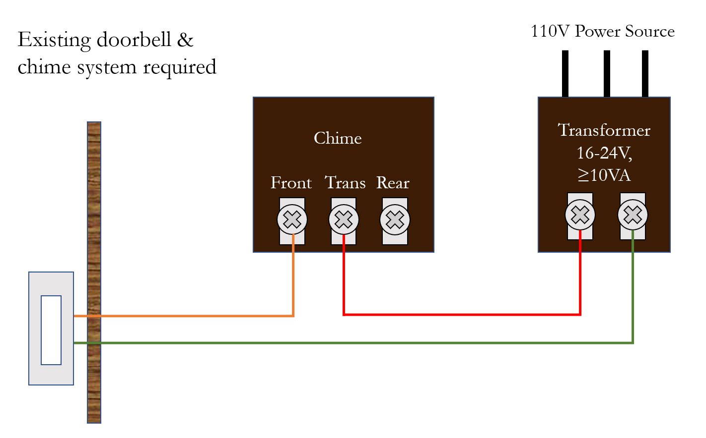

    Typically, homes with 1 doorbell have 2 wires, homes with 2 doorbells have 3 wires, etc.
    1. If you have 2 wires, follow the instructions to connect to the jump wire.
      • See the Before and After Installation graphics below for reference.
    2. If you have 3 wires, follow the instructions to select the correct door, and connect the proper wires.
    3. If you have 4 or more wires, follow the instructions to find the proper wires to connect.
      • This will involve some trial and error. If you are not comfortable testing your electrical panel, stop. Call your local electrician for help.
