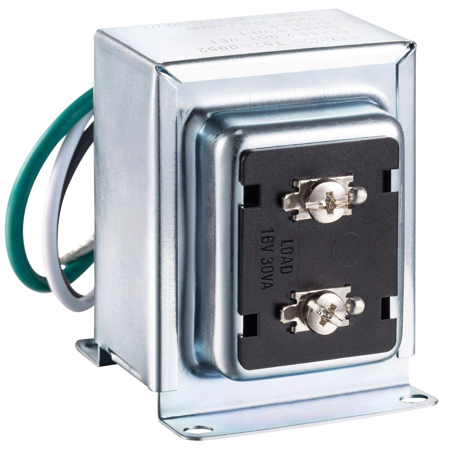

1. Check your Transformer and Voltage
Wyze Video Doorbell v2 requires a power input of 16-24V AC. If your chime is battery-powered, then it is NOT compatible with this doorbell.
If your chime is AC-powered, please check your transformer (near your chime box) to see if the power output is within the required range. If it is not, your chime system is NOT compatible with this doorbell.
Battery-powered chimes: A transformer:

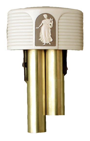

However, some older chimes make a long or slow series of striking sounds like “ding... ding... ding... ding." In these chimes, the striking parts move multiple times while chiming, instead of one short burst. Due to this different powering and cut off mechanism, these chimes are NOT compatible with Wyze Video Doorbell v2.
Wyze Video Doorbell v2 and its Wyze Doorbell Chime Controller are not compatible with:
Side-knocking round chimes Vintage long chimes
If you have one of the chime types shown above, we suggest picking up our Wyze Video Doorbell Pro. Wyze Video Doorbell Pro bypasses your existing chime, and pairs with its own chime via Bluetooth®.
