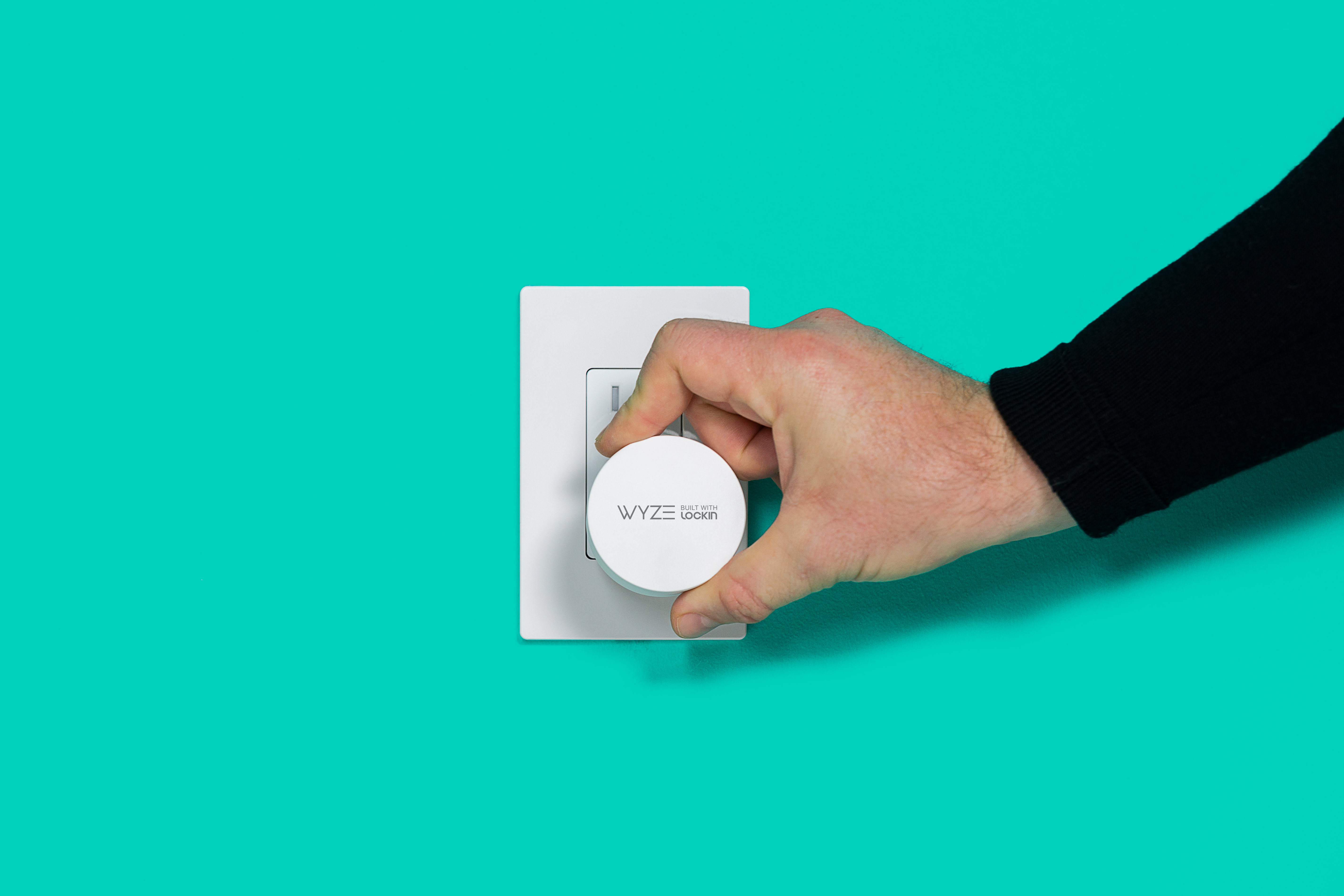

  1.  Plug in the Wyze Lock Gateway to an outlet near where you’ll be installing the Wyze Lock.

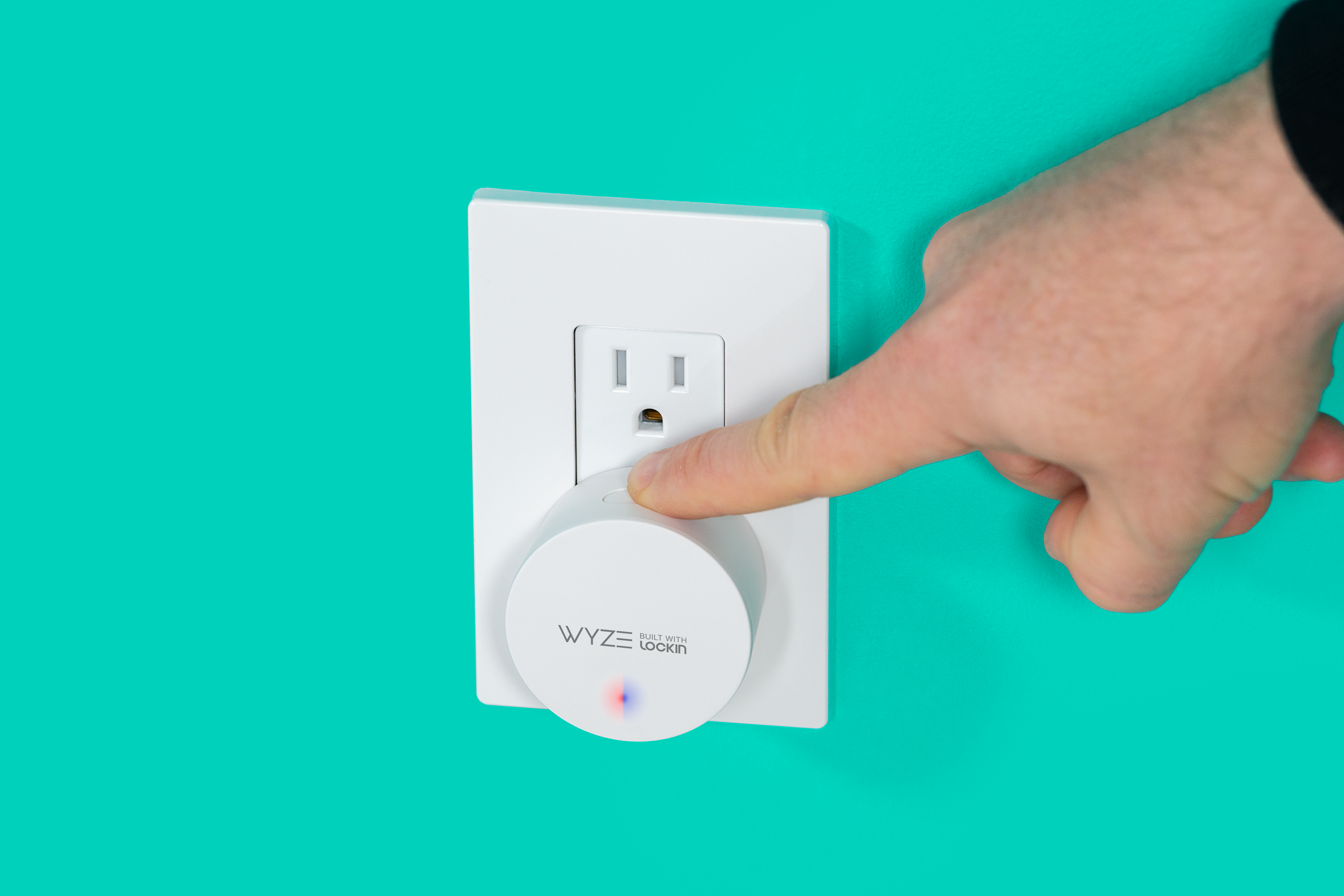

  5. By default, your Gateway should be flashing Blue/Red. If it isn't, press and hold the Reset button on top until the light starts flashing Blue/Red.

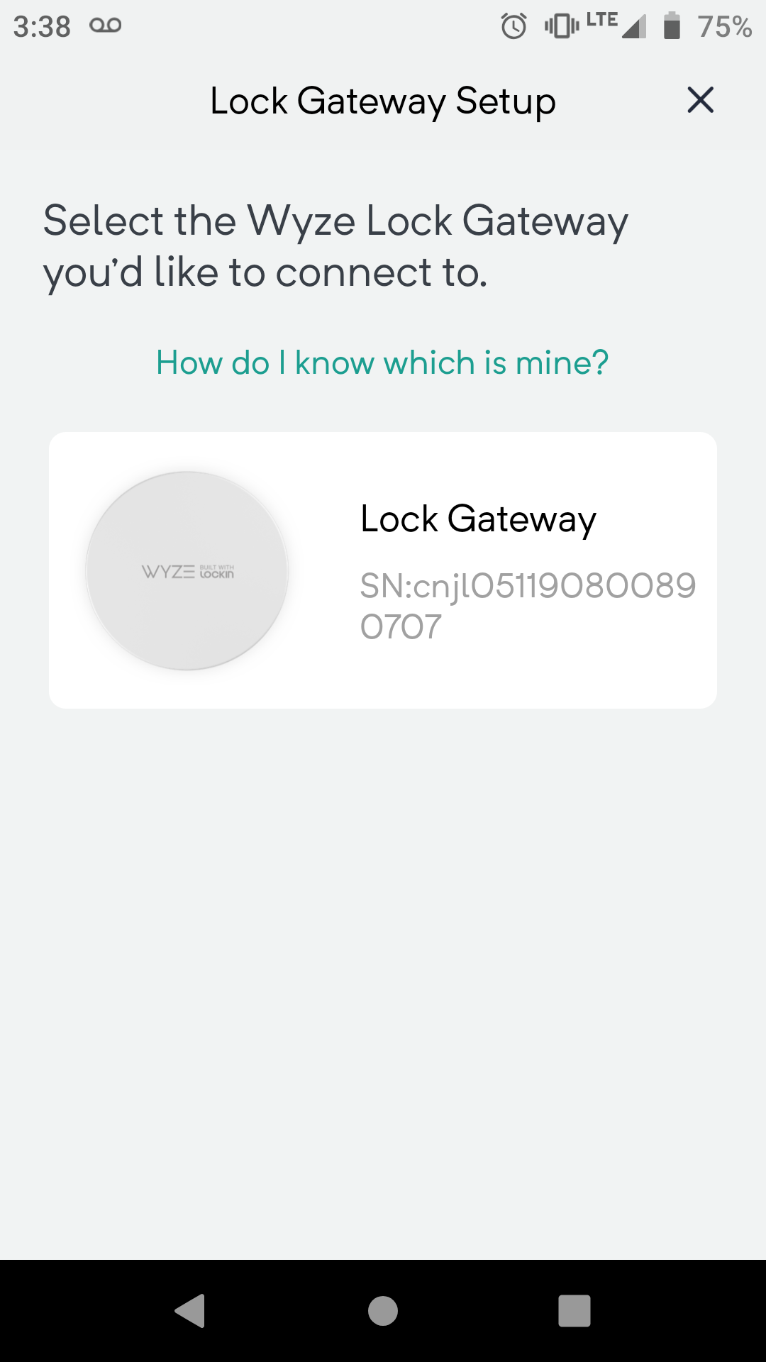

  6. Confirm the Gateway you'd like to setup from the nearby available units.
