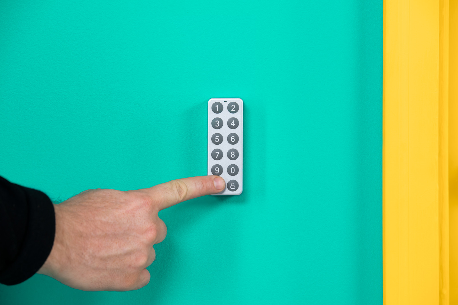

  4. Press and hold the Lock button on the keypad until the status light is flashing green.
