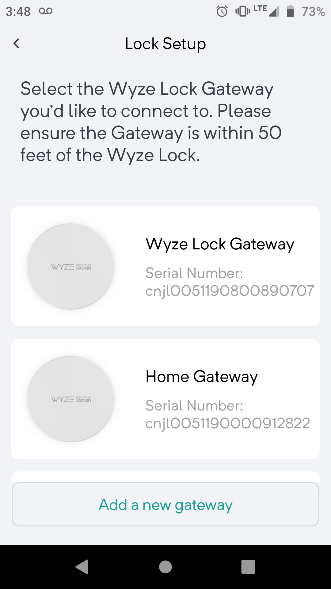

  4. Select the Gateway that you want to connect your Wyze Lock to.

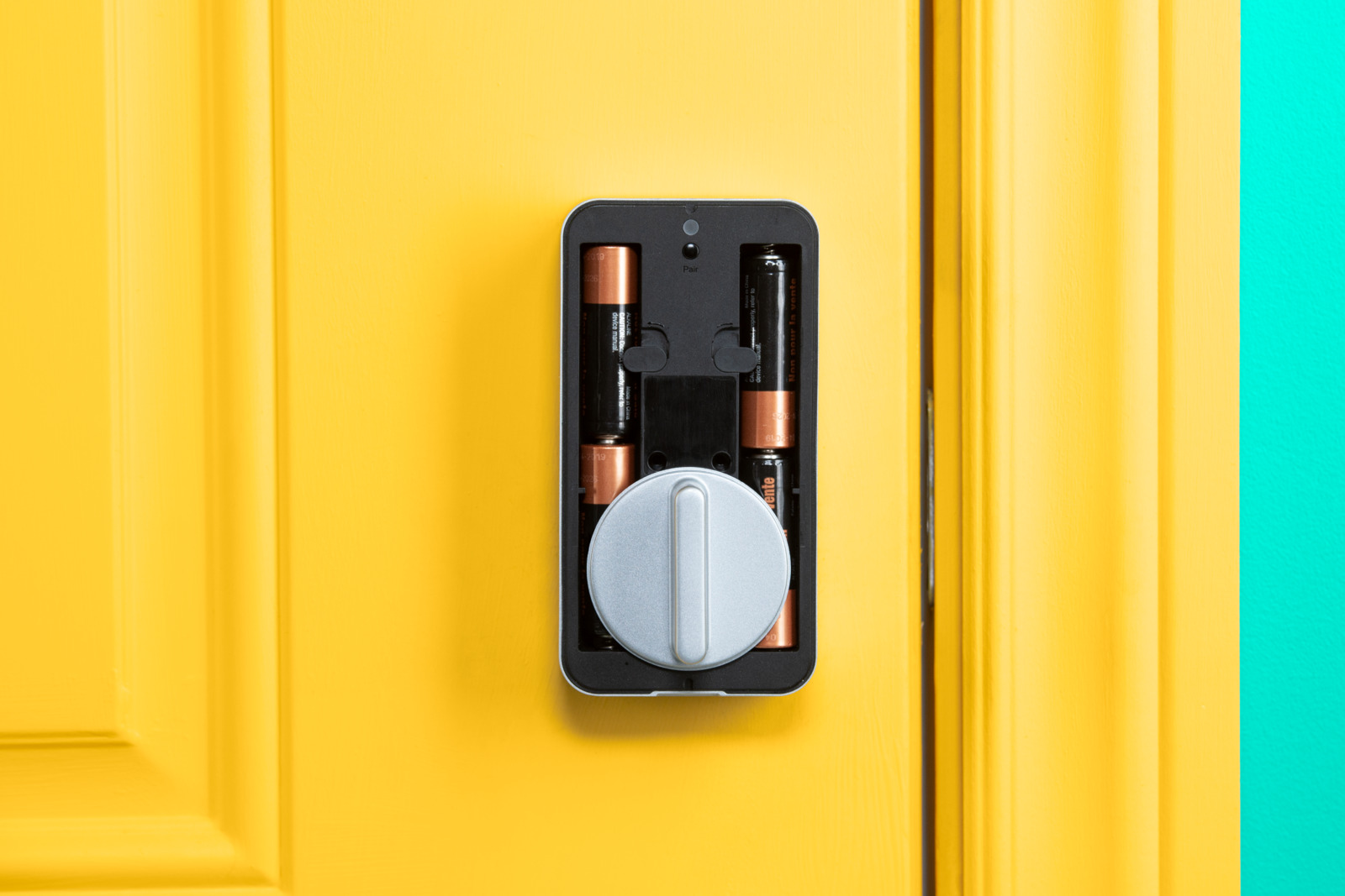

  5. If it's currently installed, remove the battery cover from the Wyze Lock.

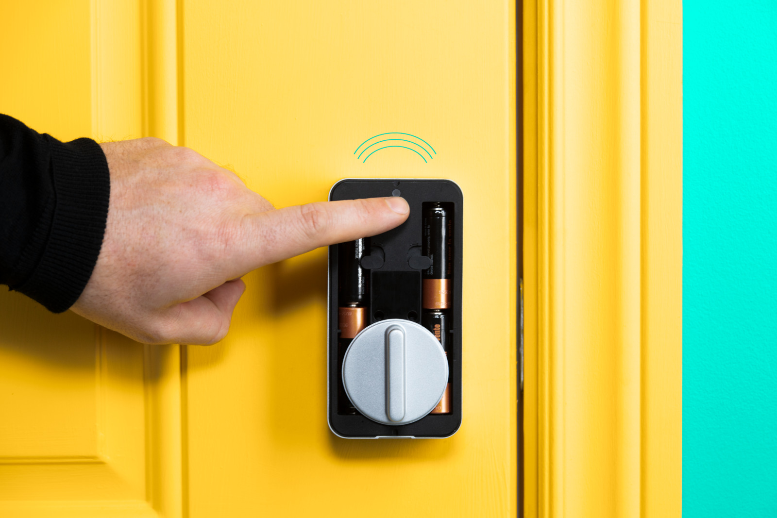

  6. Press and hold the pairing button at the top, releasing when you hear the lock beep.
  7. When the light on the Wyze Lock flashes, tap Next in the Wyze app.
