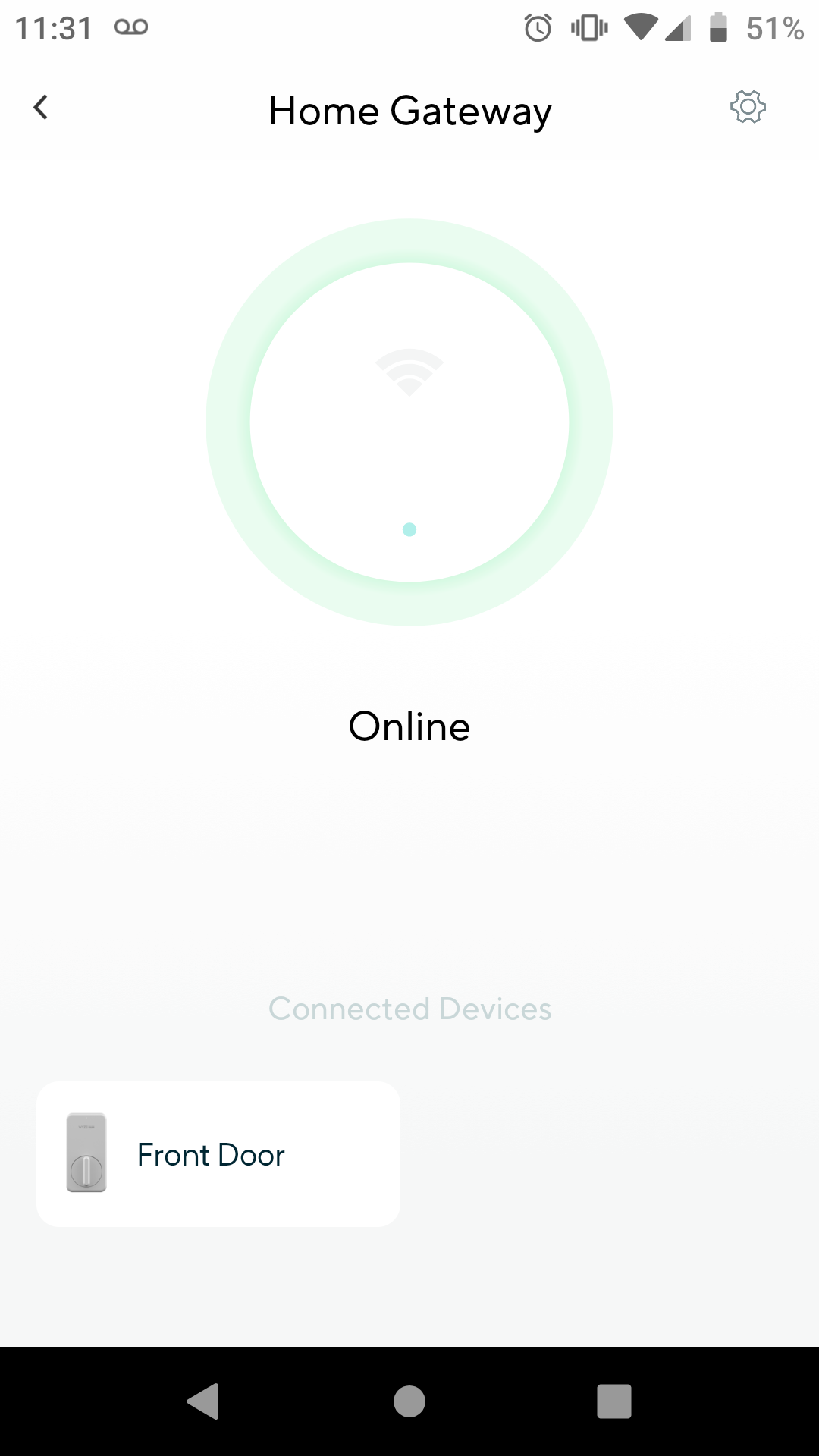

In the Wyze app, check to make sure the Gateway is showing as Online. You can use this as an opportunity to make sure the Gateway is running the latest firmware.
To check the Gateway's firmware:
  1. Open the Wyze app
  2. Tap the Gateway's listing on the Home tab to access its Product Page
  3. Check to make sure the Gateway is showing as Online
  4. Tap the SettingsGear.png icon in the top right to access the Settings
  5. Tap the Firmware listing to make sure the latest version is installed
If your Gateway is showing as Offline, check out the Gateway connection troubleshooting article for additional steps you can try.
