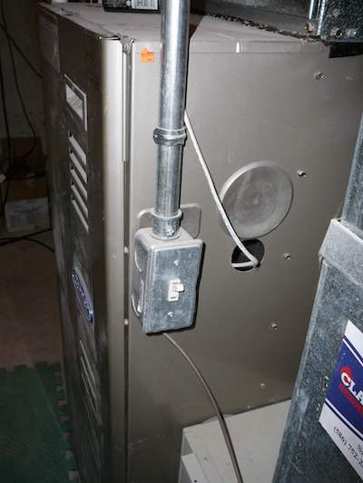

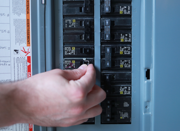

    • To protect yourself, turn off the switch that controls your heating/cooling system. You can do this at the breaker box or using the switch on your furnace or air handler. If needed, turn off the main power at the breaker box.
    • Turn down the temperature on your old thermostat. Make sure it doesn't run for at least 5 minutes.
    • After verifying the power is off, tap Next in the app.

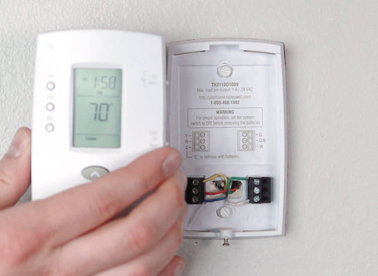

  2. Remove your existing thermostat cover.
    • On most thermostats, you can take off the cover by grasping and gently pulling. Some thermostats may have screws, buttons, or clasps.
    • Use the screwdriver to remove any screws or use the button/clasps to remove the cover. You should see wires that run from your heating/cooling system attached to the back panel of your old thermostat, and your thermostat’s back panel is screwed to the wall.
    • Important: Do not remove any wires at this step! If you don't see any wires, you may have a mid-layer that needs to be removed by unscrewing.
    • Tap Next in the app.

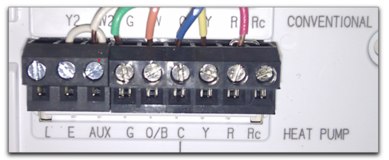

      Common confusing issues:
      1. Thermostat with 2 sets of labels: Select the terminal names based on your actual system. Some thermostats may have 2 sets of terminal labels, like "conventional" and "heat pump."
      1. Unused wire: Identify if the wire is also unused at the control panel. If it is not being used, label that unused wire with an empty sticker label. If the wire is being used, label it at the thermostat.
      1. Two wires in one terminal: You may have a dual transformer system.
      2. Incompatible wires: Stranded wires are not compatible.

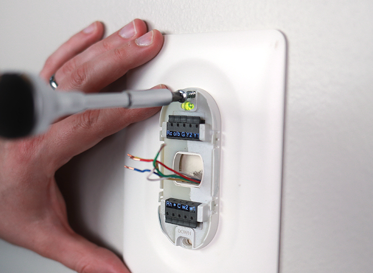

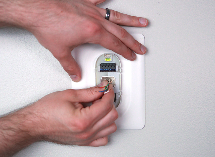

  8. Mount your Wyze Thermostat back panel.
    1. Thread the wires through the center of the back panel (wall cover is optional).
    2. Hold the back panel to your wall, use a pencil to mark the holes for your thermostat to be placed.
    3. Drill mounting holes for the drywall anchors (e.g., 3/16 inch holes for drywall)
      Use the drywall anchors and screws supplied to mount the back panel to the wall. Keep the bubble on the built-in level centered to make sure your thermostat is placed level.
      Important: You may use your existing wall anchors. Hold the back panel up against the existing anchors to check for alignment.
  9. Connect the wires to your Wyze Thermostat.
    • Push down on the levers to insert the wires into the inner holes of their corresponding terminals on the wall panel (only one wire per terminal) until it is firmly in place.
    • Gently tug on each wire to verify they are securely connected. To release the wires again, push down on the terminal levers.
      Important: Make sure the wires have at least 1/4'' of wire exposed for inserting to the back panel terminals.
