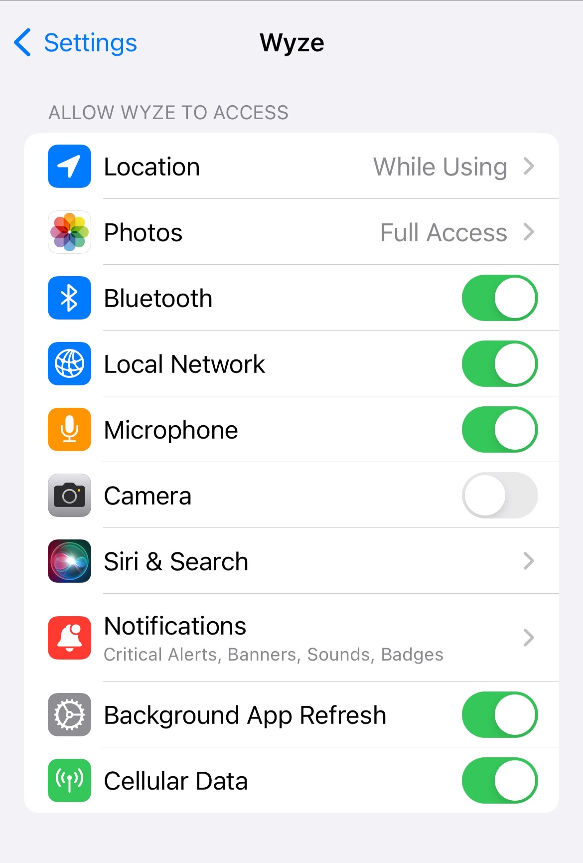

This issue is often due to your local network access settings not being enabled on your device.
  1. Open the Settings app on your iOS device.
  2. Search or scroll down to tap the Wyze app.
  3. In the Wyze app Settings, tap to toggle Local Network to On.
