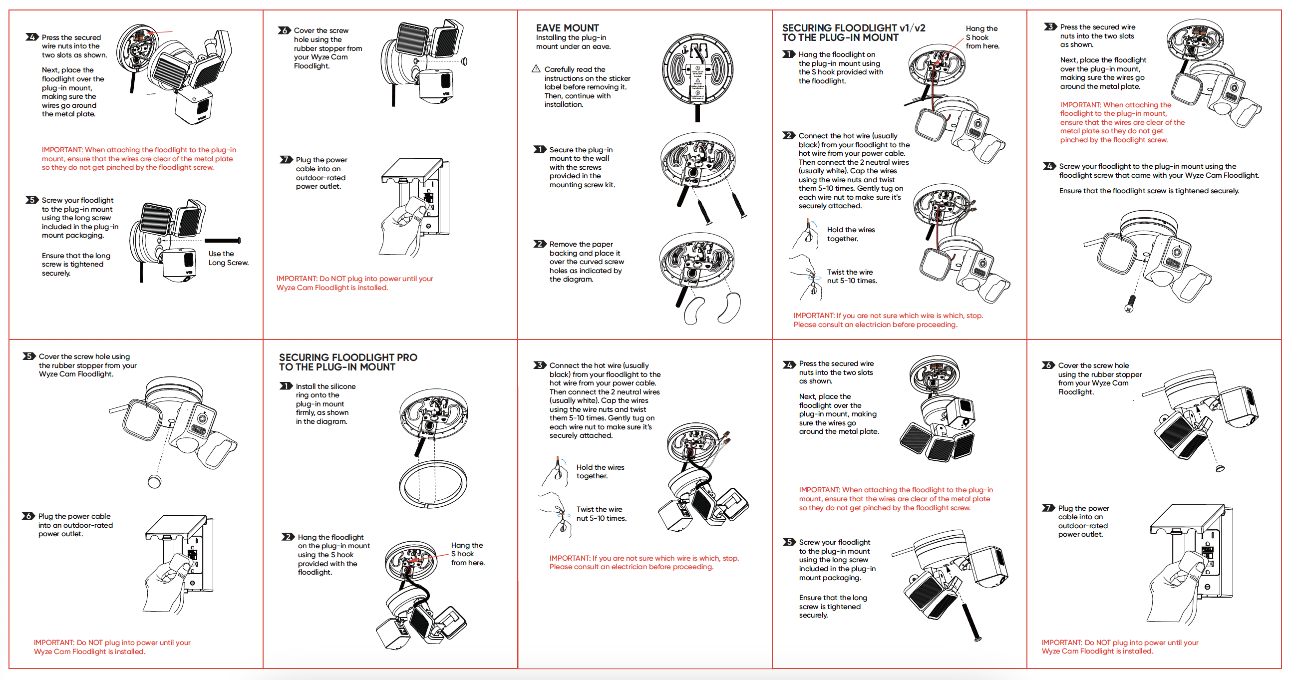

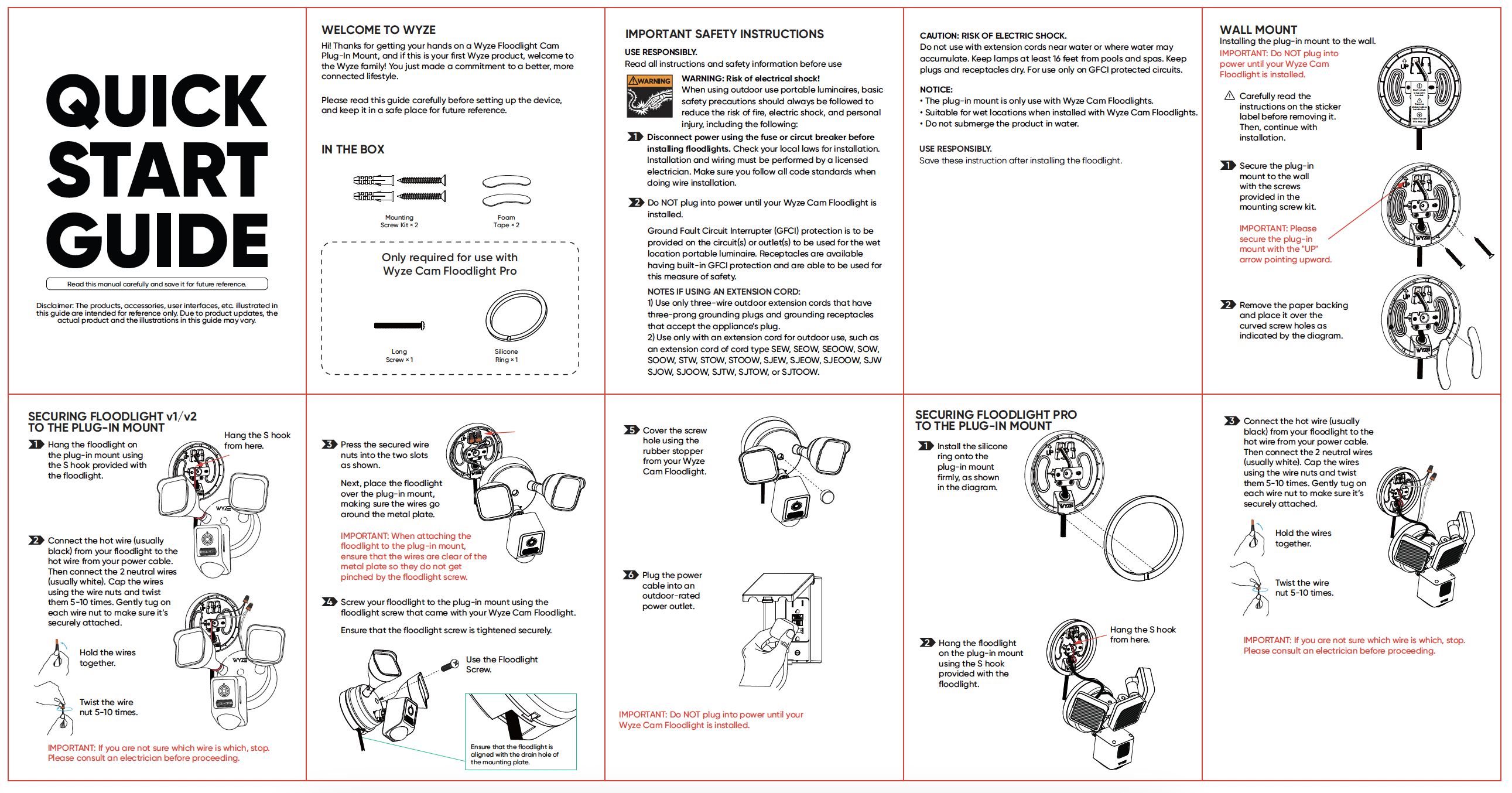

Below is the Quick Start Guide for Wyze Floodlight Cam Plug-In Mount, a manual for how to install the device and secure a Wyze Cam Floodlight the mount.
This guide is a user manual with the basics about Wyze Floodlight Cam Plug-In Mount including:
  • What's in the box for Wyze Floodlight Cam Plug-In Mount.
  • How to install your plug-in mount.
  • How to install your Wyze Cam Floodlight device onto the plug-in mount.
