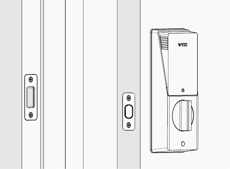

Before calibrating:
To calibrate your Wyze Palm Lock.

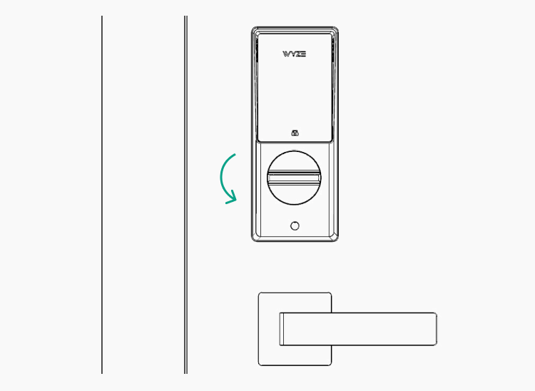

  3. Close your door and manually lock the deadbolt.
    • Check the box next to "I have turned the thumb latch. ✅
    • The Wyze app will display "Calibrating your device..."

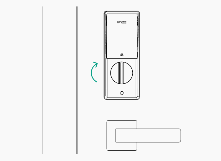

  4. Manually unlock the deadbolt and wait for your Wyze Palm Lock to sound.
    • It will say "Please open the door."
