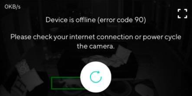

I get "Device is offline (error code 90)" in the app.
Problem
When accessing your Wyze Cam device(s) in the Wyze app, this message displays:
"Device is offline (error code 90). Please check your internet connection or power cycle the camera."
