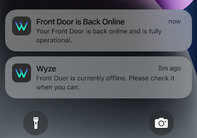

Internet down? Power outage? Device Connectivity Notifications will send a push notification to let you know when your Wyze Cams go offline and when they come back online.

How do Device Connectivity Notifications work?
When your Wyze Cam goes offline, it automatically tries to reconnect for up to 30 minutes. If it's still offline after that, you'll get a push notification. The 30-minute window helps avoid false alerts from brief power blips or Wi-Fi interruptions. You'll also get a notification when your camera is back online.
